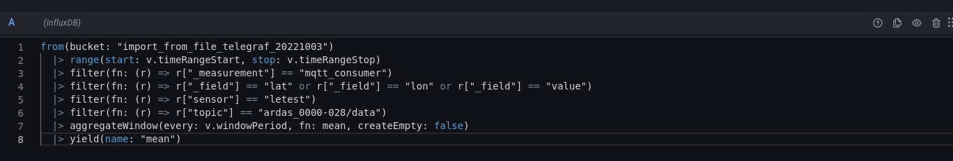

Hello, I am trying to display the coordinates on Geomap but unfortunately it does not work. I have the right name in _field but for some reason it doesn’t work.
I have already tried to look at different existing topics but no solution works so I try here.

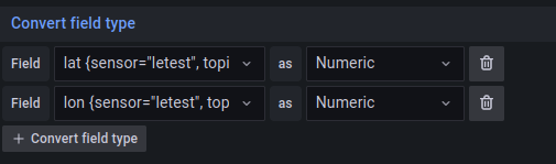

Your English is spot on. Use transformation to conver those lon,lat to numeric. Then make sure to use markers that have the coordinates lon,lat
thank you for your reply but unfortunately nothing has changed
Oh really thanks you, now it’s working
