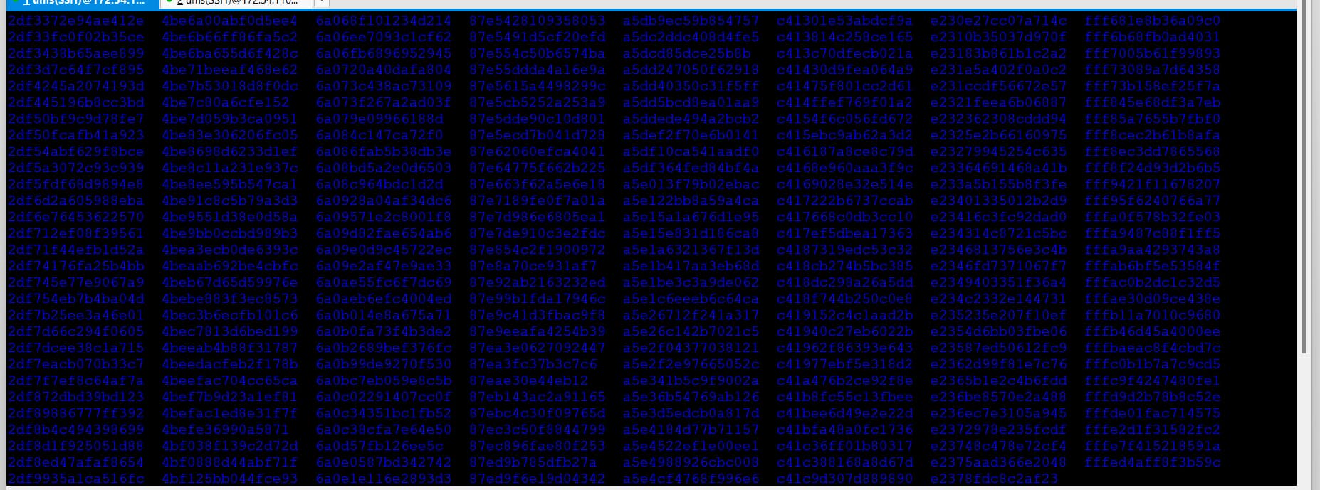

Loki miss chunk file in /loki/chunks/fake
Sometimes Loki and Promtail would be rebuild in k8s for updating config or collect old logs, and I find that many directory are under /loki/chunks/fake.
I know that ‘fake’ was the orgID configuration, and I want to know what is the files under the path ‘/loki/chunks/fake’?
It seems like 16 bits num , how these directory names produced?
This make Loki can’t find chunks.

What confuses me is that:
1.If Loki know to find the chunk file ‘/loki/chunks/fake/c7bcc606af799e49/MThmNTBmNjYwOWU6MThmNTI3NDM1M2I6MjkxNDIwZGY=’ , it means the index file are providing services normally.
2.I have seen that chunks files were saved under the path ‘/loki/chunks/fake’, how is the directory ‘/c7bcc606af799e49’ produced?
3.I don’t delete any chunks files or remove them, and I,m sure about that the nobhub path is same before I rebuilded Loki, and I can find the chunks files. It’s that ‘/c7bcc606af799e49’ was calculate by some way or configuration?

That’s so many directoried under /loki/chunks/fake, I really want to sure the rule about calculating the hash value, but I can’t find these in the program code.
