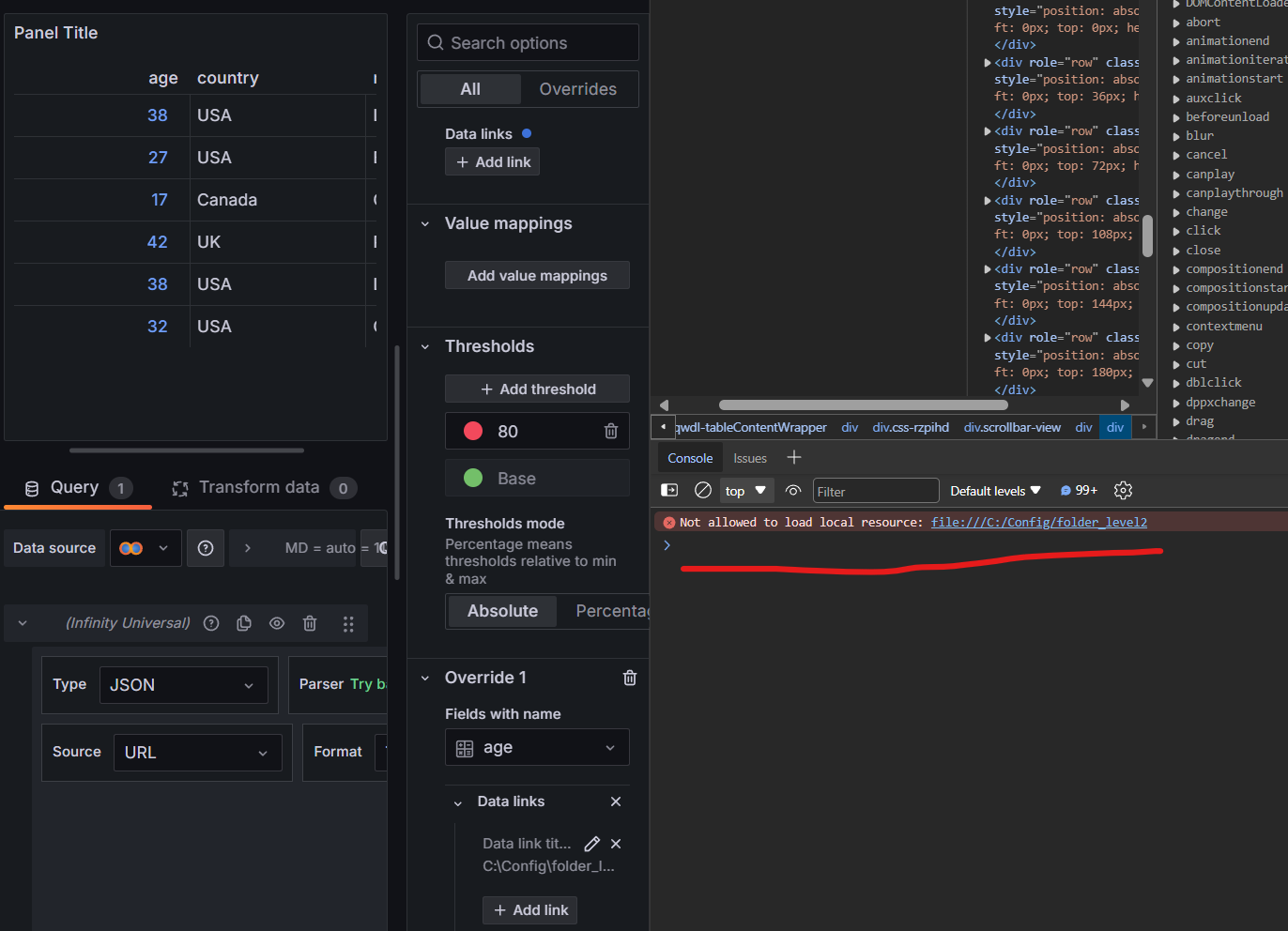

I tried adding the below add in data links but, its not working.
${__data.fields.FOLDER_PATH}
Also I tried using the file:/// scheme and replace backslashes (\) with forward slashes (/). Still on clicking the “FOLDER_PATH” value nothing happening

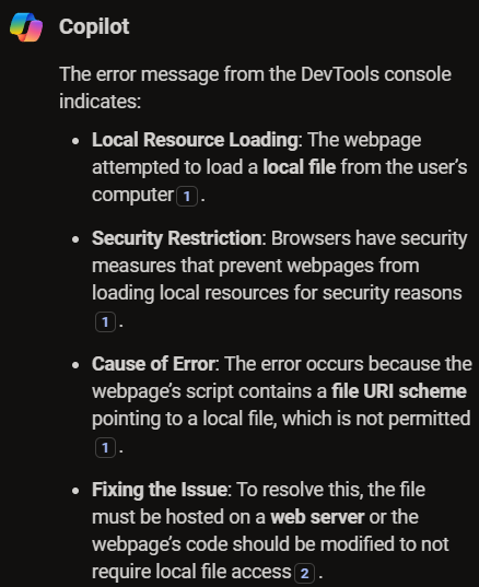

So, the error message you posted explains the reason (local resource loading) and one solution (host the files on a local webserver and translate your file paths to a web address).
The only other solution I know is what I said already, but I don’t use Windows so don’t know the Windows directories/commands, but there may be a way to mount on Windows the same way. So the idea is to:
create a file mount point within Grafana directories, e.g. on Ubuntu mkdir /usr/share/grafana/my_mount_point
Mount the directory (bind mount on Ubuntu) where your files are to that mount point e.g. so when you do a directory listing of /usr/share/grafana/my_mount_point it lists your files even though they are actually stored elsewhere. I don’t know what mounting/sharing options Windows provides.
Translate your file paths in Grafana so if your database is for example referencing T:\Folder_level1 you translate the T:\ to your Grafana mount point directory.
