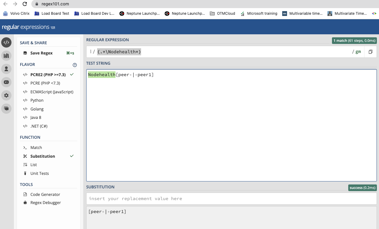

I am trying to rename the column names retured by OCI Metrics explorer.
Column name is coming is “Nodehealth[peer | peer1]”
I am trying to use rename by regex transformation but can able to do it… To make it simple I am just replace Nodehealth with blank in first step using the below transformation but it is not working.
It works on regex101.com but not in grafana transformation. Am i missing something here?

Hi @tiwariyogi,
Welcome to the
community support forums !!
on the regex101 select “Golan” in the flavor as the Grafana backend is written in Go programming language.

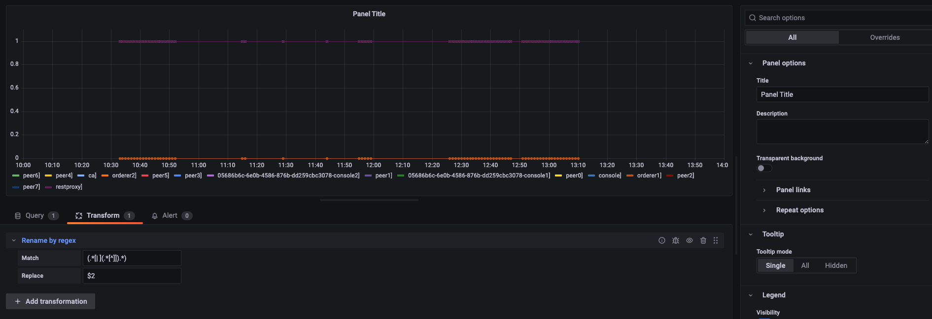

I managed to do a part of it… My input is ‘Nodehealth[peer | peer6]’
With regex (.| .) and replace as $2 it seems in regex101.com it is doing the replacement correctly but when I do it in the Grafana transformation then it is not removing ] from the end
Please advise
