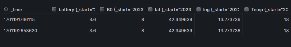

Everything seems to be working correctly, but when I retrieve the results, the column titles contain data in JSON format. I can’t figure out why this is happening
Has anyone encountered a similar issue, or does anyone have any suggestions on how to resolve it? Perhaps there’s something wrong with my query?
Thanks in advance for any help!
I use Grafana v10.0.3 (eb8dd72637)
