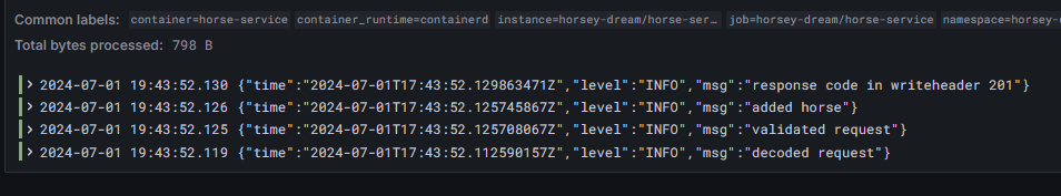

Of course I can share an example! Here are the full logs I got during a particular timeframe (using explore with the correct datasource)

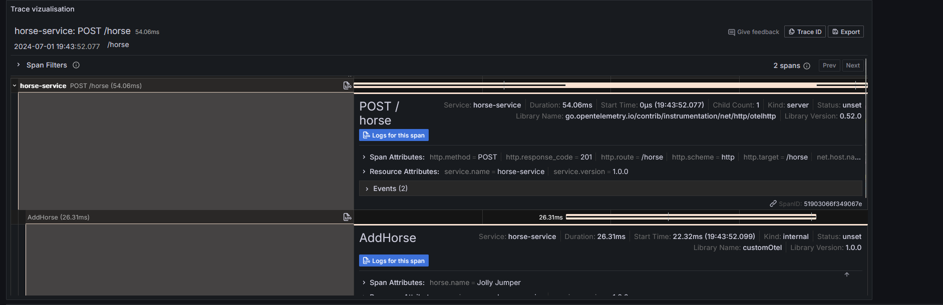

I have my trace here:
As you can see, the timeframe is similar. So we should get all the logs I showed in my first picture.

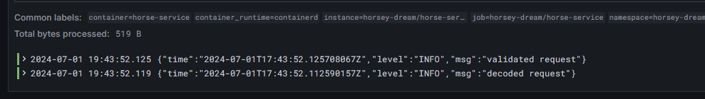

If I click to see the logs of the first span:
If I click to see the logs of the second span:
The last log in my first picture is nowhere. If I look closer, where this log is emitted, it’s in an http handler:
