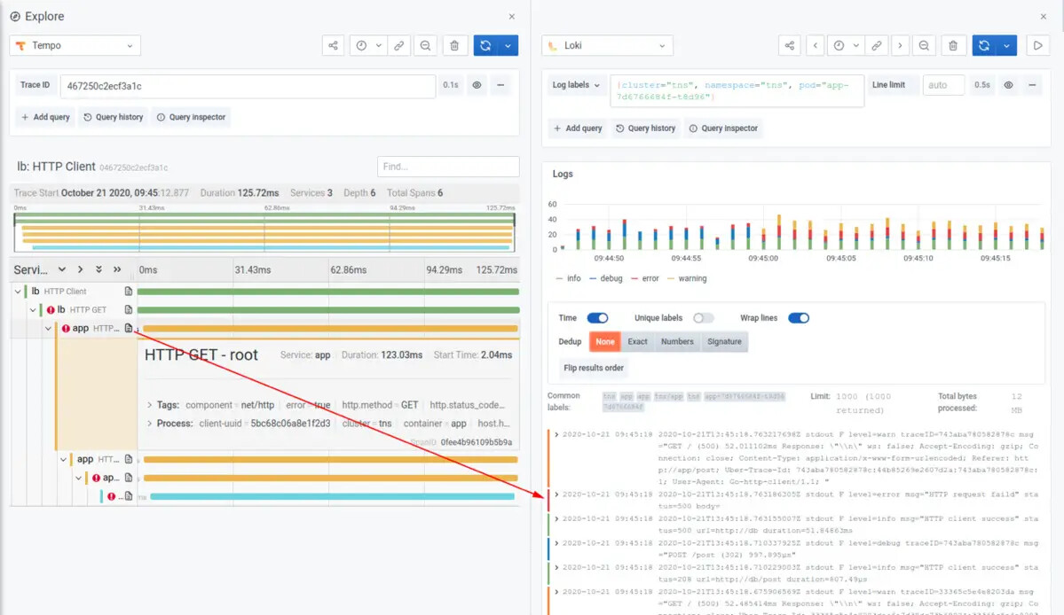

I can already jump from logs to traces by using derivedDataFields. But reversely, I’m super interested in how we can jump to logs from a trace (like the image below):
The particle didn’t provide any detailed hint on how to achieve this result. Much appreciated if someone can point me to an example.
