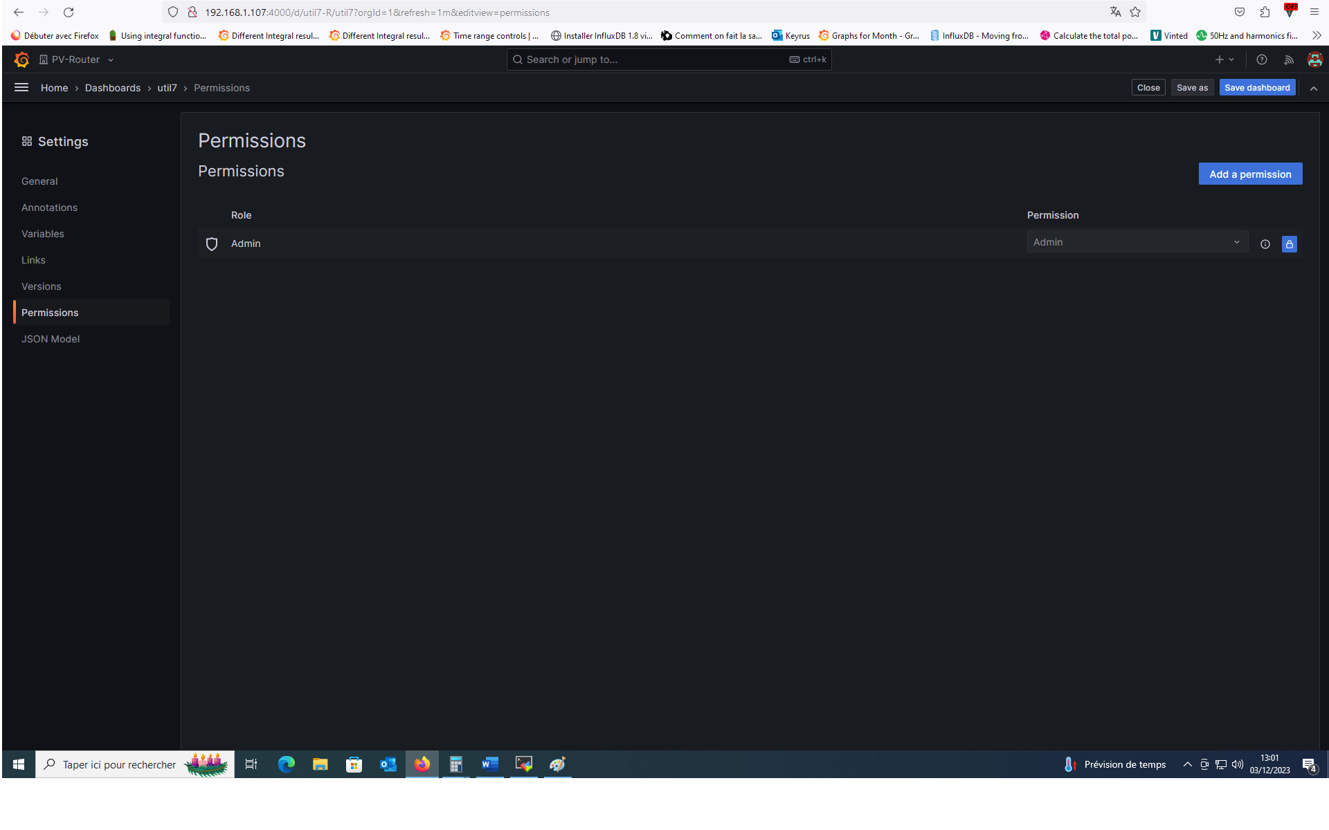

Today, I can import a dashboard via the HTTP API and I can create the user, but impossible to add permission to the user the view the imported dashboard.
I follow the API reference guide and today the program finish with success but all permissions are removed except the Admin.
see the pictures of the permissions, before and after my program.

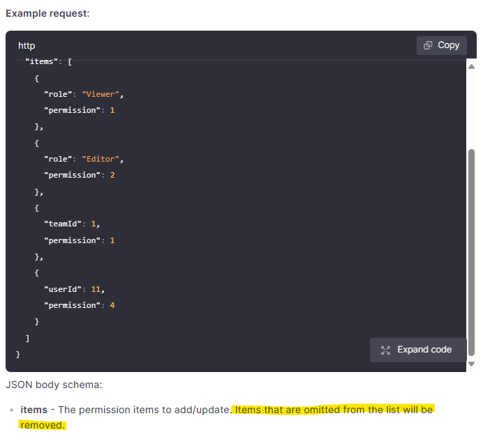

Hi,
I see your json payload only includes the new permissions you wish to set, the documentation is pretty clear that if you leave any of the existing permissions out of your payload, they will be removed…
Yes, I understand that the viewer and editor role have been removed because I have not put them in the json (it is what I want indeed). But my user is not added.
Even, when I add the “admin” user I got the same result: The user is not added to the permissions to the dashboard.

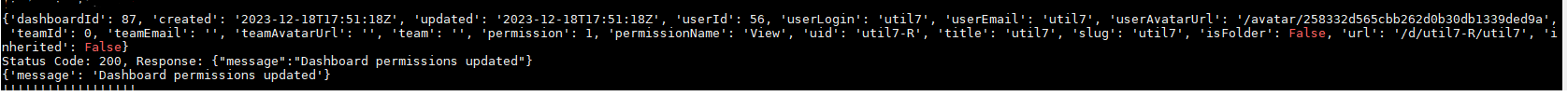

here the message from the API response:
Status Code: 200, Response: {“message”:“Dashboard permissions updated”}
{‘message’: ‘Dashboard permissions updated’}
So API request is correct. Payload is probably wrong. As I mentioned: use browser console and construct right payload.
