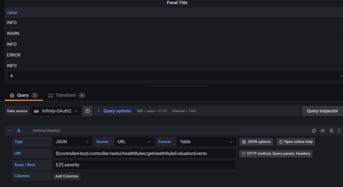

I’m trying to get, from each query I made, the highest between ERROR-WARN-INFO, information that comes from a request to an API in a json object property. I tried with different transformations, but as they are not numbers I can’t use the reduce one with “max” and I wasn’t able to convert them to numbers either. Also, I tried using simple jsonata in the row section but didn’t work… So up to now I have this:
I would like to have a merged table that says the highest valure for each frame.

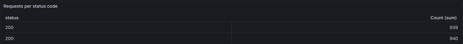

I tried a solution that seems to work:
Here I have the column “status”, that has the values “200, 404, …”.

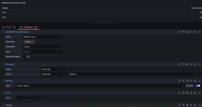

- I added a new field with values 1 to all the the rows.
- I grouped by the column “status” to get the sum (total) of all those 1’s for each “status”.
- I ordered the values reversibly and then limit the rows by 1 to keep only the max.
- I added the “merge” transformation to combine the results from the 2 queries.
