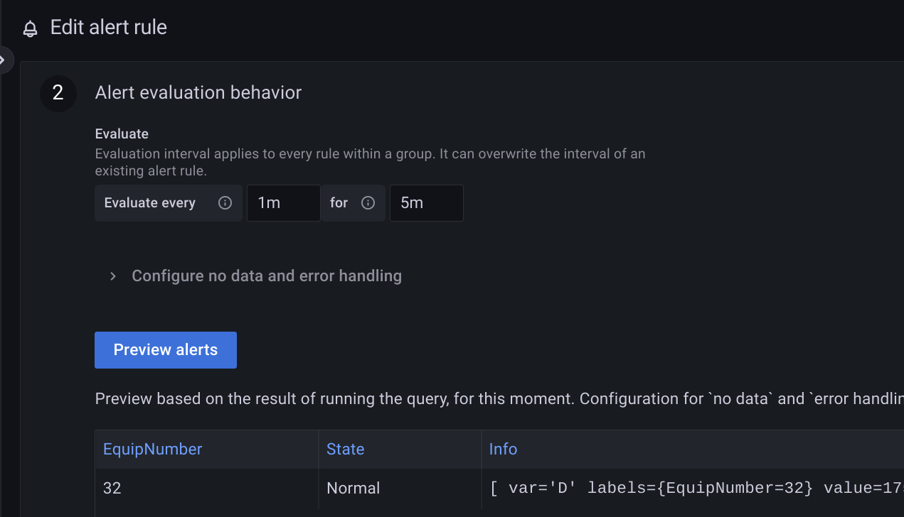

Unless the log content appears in the Preview Alerts box, then I do not know how you can get it into your Slack template.
Do I have to do something to make it appear there?
Have you created an alert that is currently working? If yes, what do you see when you click on the Preview Alerts button?

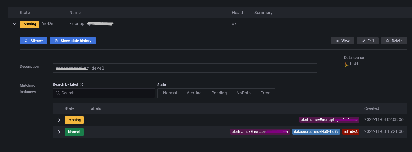

I only see this
I just have that rare value
Click Edit (upper right in your screenshot), then scroll down to the Preview Alerts button and click it, then paste the output here.
i only get this
is it because of the type of query?
or how could I have more information about my log?
I think you will have to go back and redo your query so that it produces the info you want in the Info section of your Preview Alerts box.
There may be a better way to do this, but grabbing log data is not my forte.
