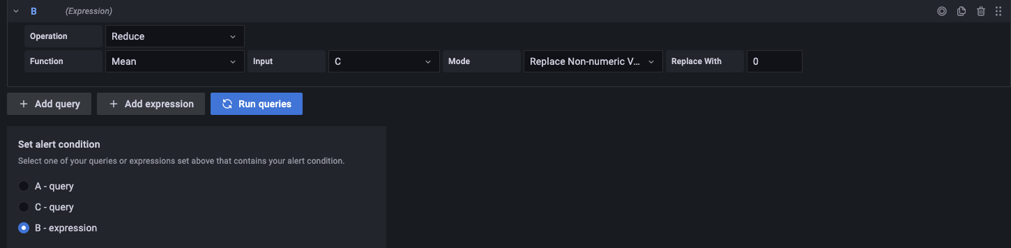

@melori.arellano do you know what tweaks are needed when not using a classic query as the current example returns two results with a reduce and use C for results alert:
I have tried $values.C in the alert in place of $values but the results in the email just ignoring the options:
Thanks
@ardianre these instructions are meant to be for slack. The webhook has a different format the json body sent uses the valueString property for the metric values returned by the alert: Webhook notifier | Grafana documentation
@mrdibbley Can you share an example of the reduce condition? I tried an example that uses input C as the alert condition and it still worked for me:
When I preview the alert, the values are in var=B even though it references the query result C:
My alert returns only the results of expression B (based on query C):
Screen Shot 2022-08-01 at 7.20.55 PM
@melori.arellano sure I’ve got it working with the following:
Thanks
@mrdibbley thank you for sharing this! Can you also show me what shows in the box when you click Preview Alerts button? That will show me what the values look like.
@melori.arellano sure here you go:

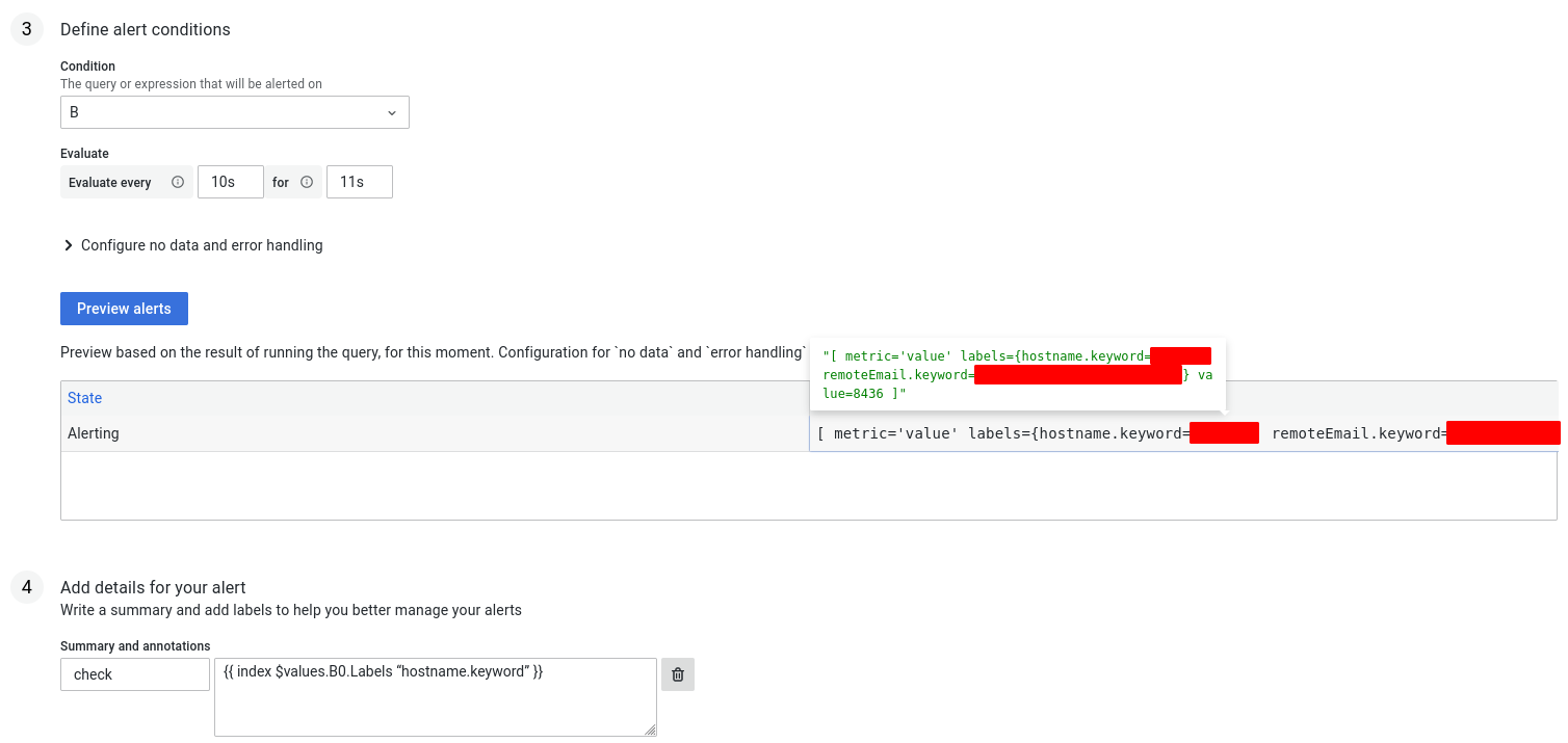

Hi melori,
I have this exact issue and i have been stranded for days now.
This is my alert preview
Can you please assist with how the template will be?
@sijuade644 What values are you trying to display in your alert?
You should be able to do something like:
{{ index $values.B0.Labels “host.hostname” }}
