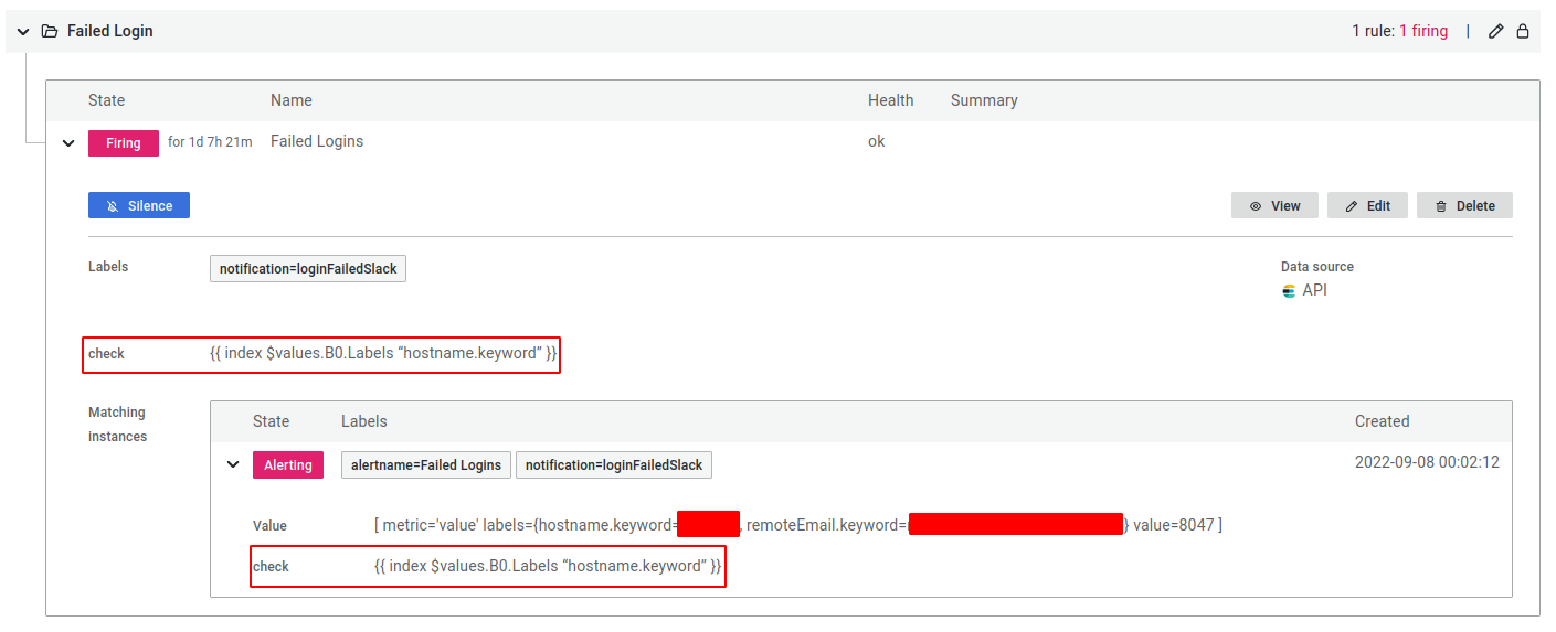

Hi @melori.arellano, you are right about the first case - I’m not receiving any data in my “check” Annotation.
Could you please help me on how to extract the “hostname.keyword” and “remoteEmail.keyword” from the Value field? Is this even possible? What would be the way of extracting those values in the case I have an array of these set of values as an output? For instance:
[ metric='value' labels={hostname.keyword=a, remoteEmail.keyword=aaa@aaa.com} value=9999 ], [ metric='value' labels={hostname.keyword=b, remoteEmail.keyword=bbb@bbb.com} value=1111 ]
