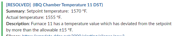

A message template is something like this:
Inside of the above message template, we have {{ .Annotations.summary }} and {{ .Annotations.description }}, which means we will display this data:
This results in a Slack alert that looks like this:

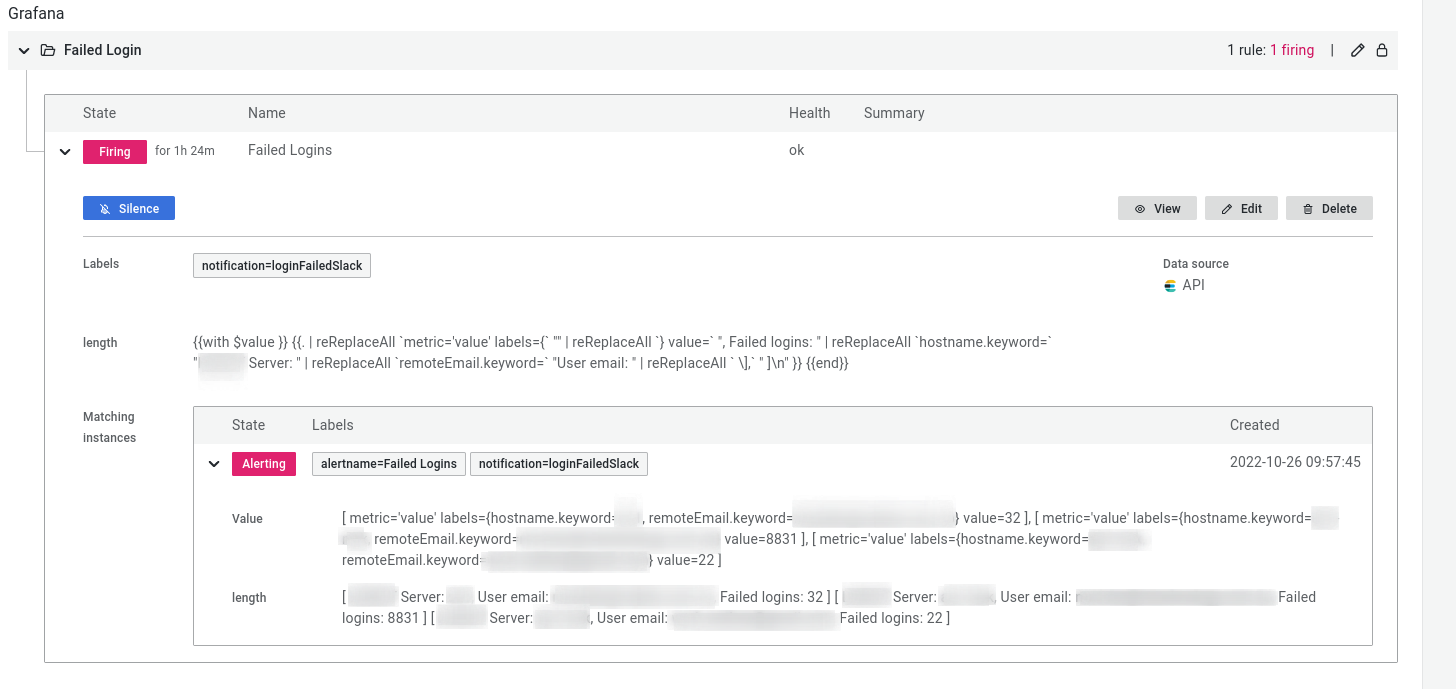

Hi grant, thanks for the quick answer. I actually got a workaround using the reReplaceAll function. My issue now is that I’m not receiving any data in Slack.
If I use the default message I get the information I’m looking for (leaving Text body empty):
**Firing**
Value: [ metric='value' labels={hostname.keyword=xx, remoteEmail.keyword=xx@xx.com} value=32 ], [ metric='value' labels={hostname.keyword=xx, remoteEmail.keyword=xx@xx.com} value=8831 ], [ metric='value' labels={hostname.keyword=xx, remoteEmail.keyword=xx@gmail.com} value=22 ]
Labels:
- alertname = Failed Logins
- notification = loginFailedSlack
Annotations:
- length =
[  Server: xx, User email: xx@xx.com, Failed logins: 32 ]
[  Server: xx, User email: xx@xx.com, Failed logins: 8831 ]
[  Server: xx, User email: xx@gmail.com, Failed logins: 22 ]
Source: http://grafana.staged-by-discourse.com/alerting/gvUNplWVk/edit
Silence: http://grafana.staged-by-discourse.com/alerting/silence/new?alertmanager=grafana&matchers=alertname%3DFailed+Logins%2Cnotification%3DloginFailedSlack
And I want to get the Annotations “length” part, so I create a template as:
{{ define "myalert" }}
  {{ .Annotations.length }}
{{ end }}
And my text body as:
Alert summary:
{{ template "myalert" . }}
But I’m receiving an empty message. As you can see from the message above this Annotation is not empty, and here I also show it to you:
Thanks for the help :slight_smile:

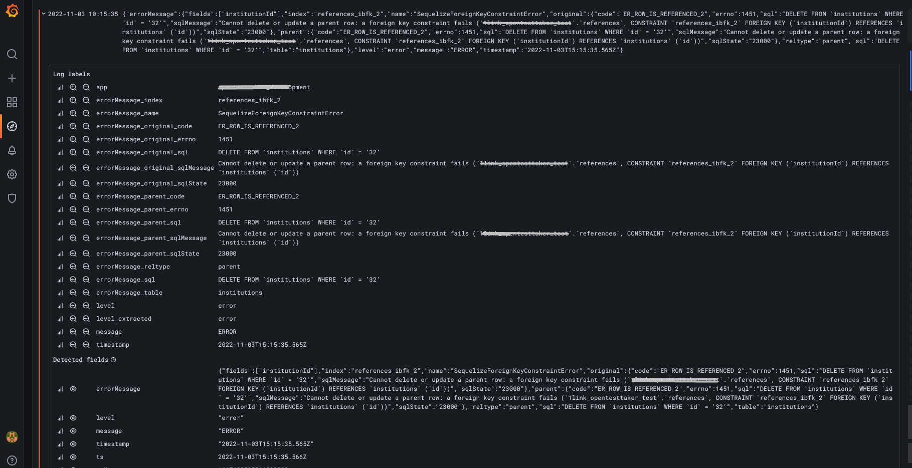

@melori.arellano @grant2 Hello, could the templates be used to send the content of a log in json format? I want to notify whenever there is an error type log and send the content of the error to Slack. I have my logs centralized in loki
this would be the content of my log
If you could help me please, I’ve been researching about it for days but I have no result
