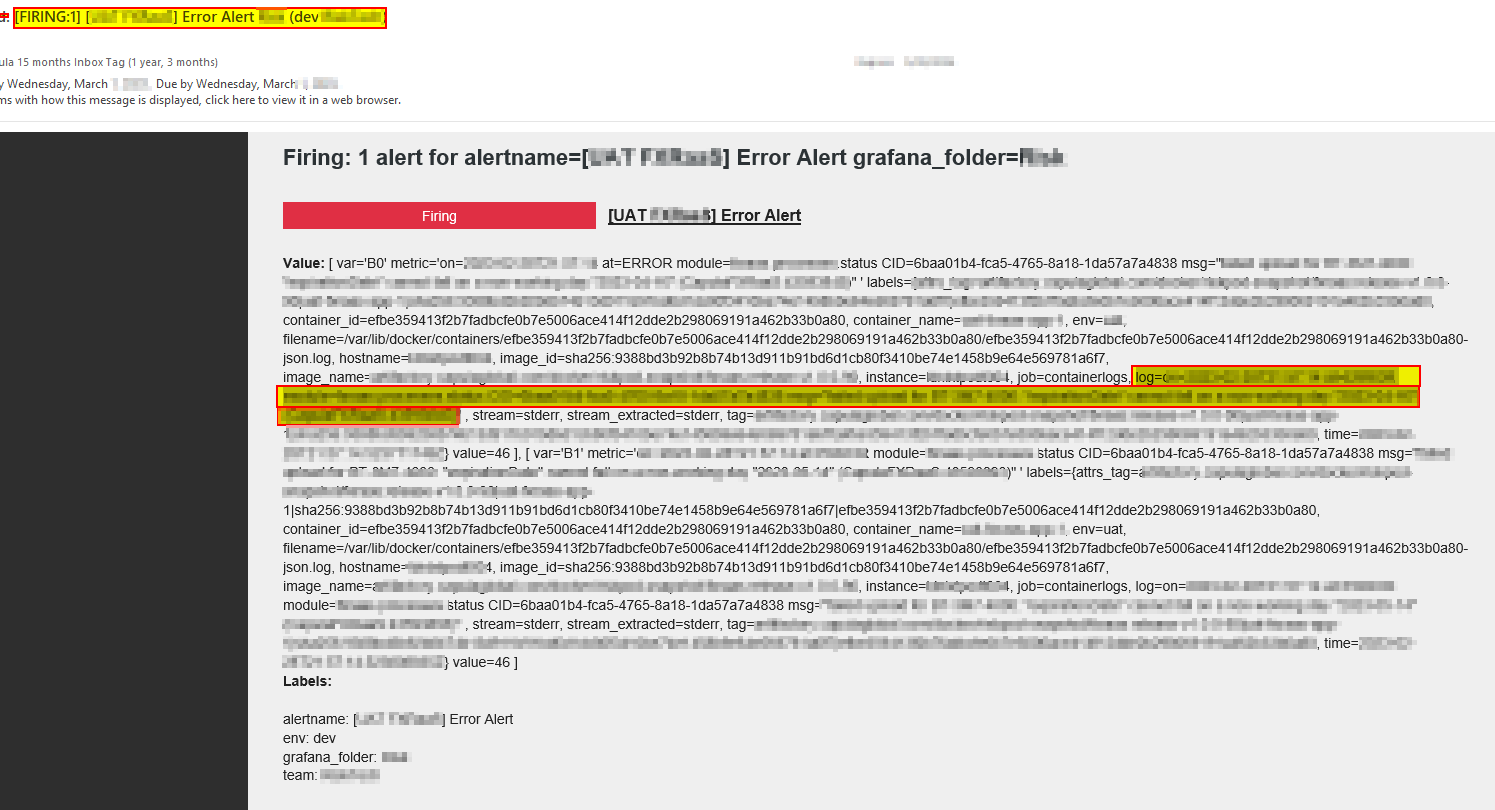

Hi George,
As discussed, please find the details as follows and would appreciate if you could help to formulate the template.
The output information in the current email alert is quite explicit and contains lots of extra details, thus would like the notification email to look in a more readable format.
In particular, we would only want to get information of the log argument out of all the rest info as shown on the screenshot attached (could be also helpful to have the instance/hostname and the container_name arguments).
Please let us know if you need more information.
Thanks,
Eugene

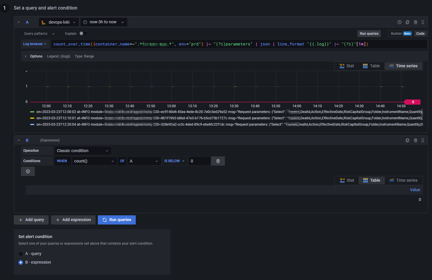

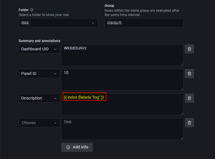

Thanks for your response. I’ve updated the alert rule to use the Reduce expression though the email alert was received in the following format. -
Please find the rest of the steps are set as follows.
  1. Changed the alert rule to use the Reduce expression (please let me know if it needs to be updated as well).
  2. Added the summary description to the alert rule. -
  3. Created the custom notification template.
  4. Updated the contact point.

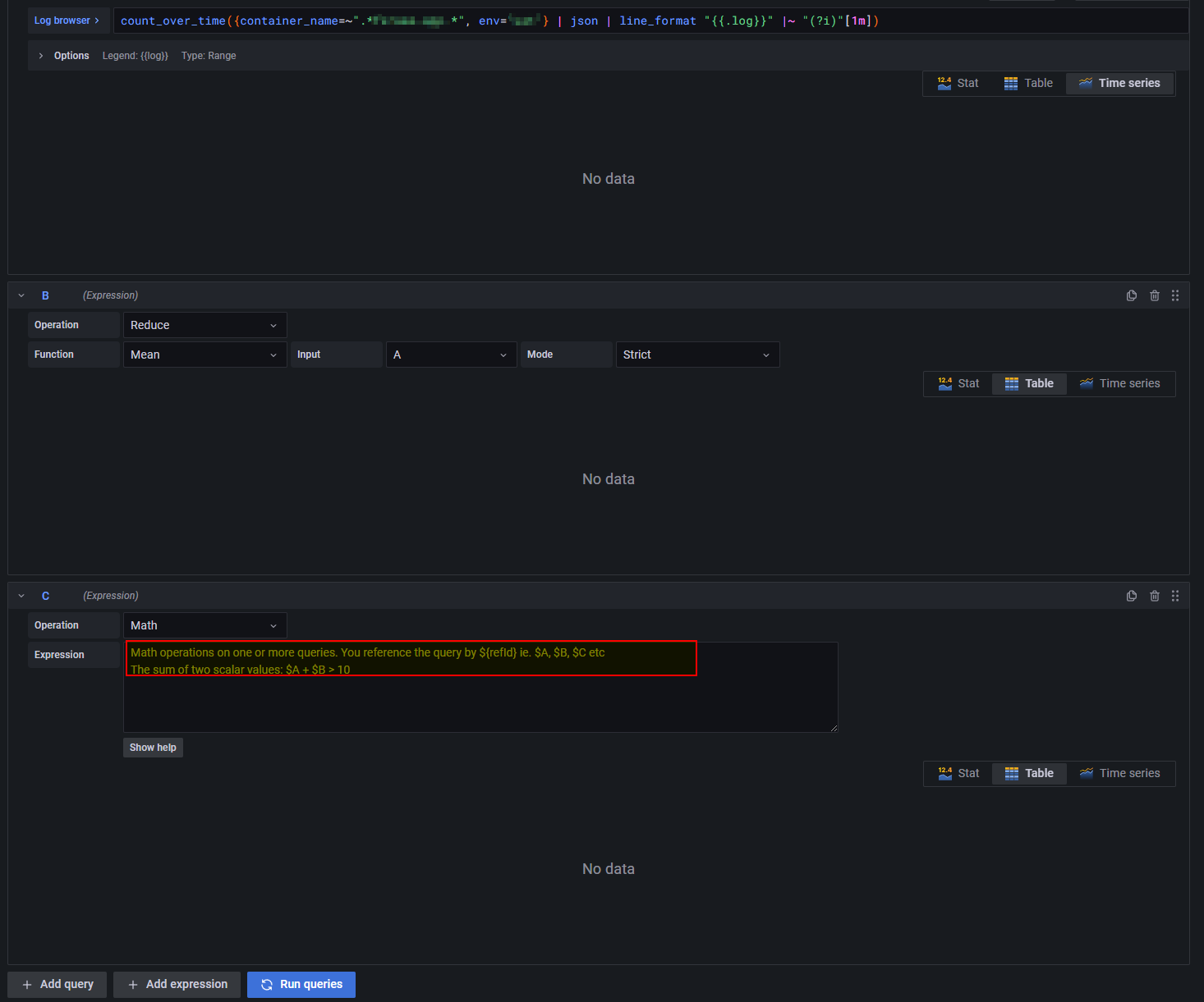

You are using Loki, right? Do you want to alert if count_over_time is more than 0, or is it some other number? If its 0, you need a Math expression, just a Reduce expression. If its another number, like 5, then the Math expression should be $B > 5.

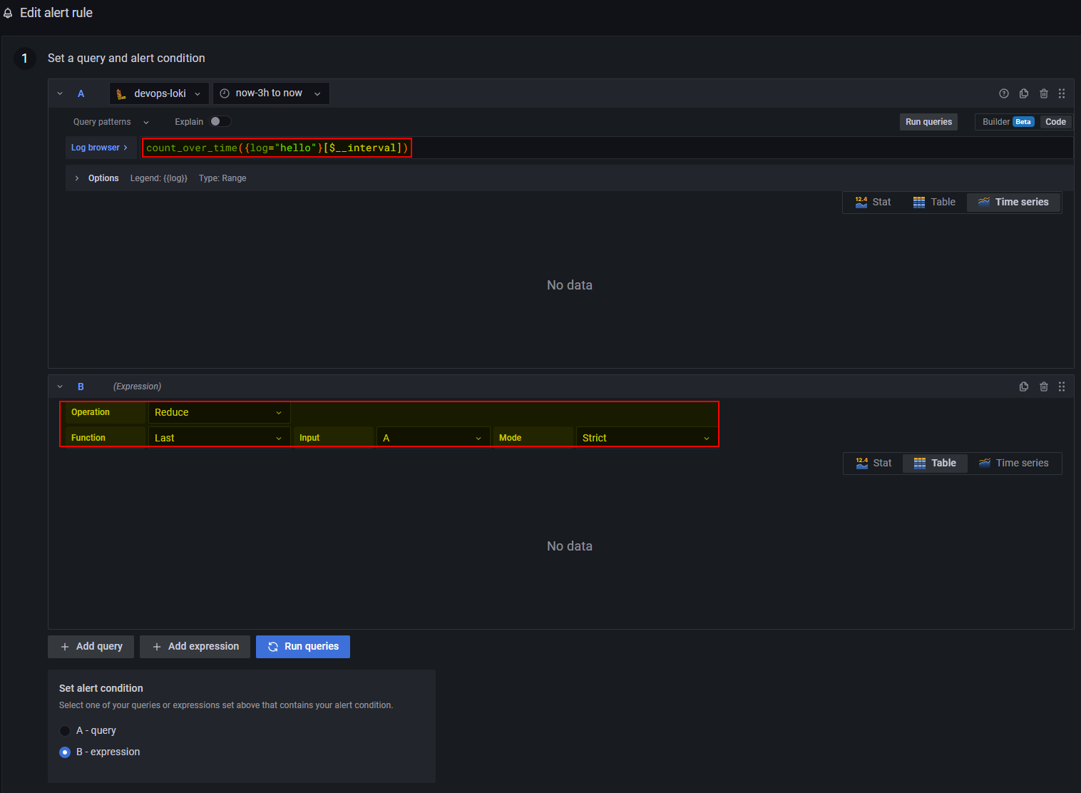

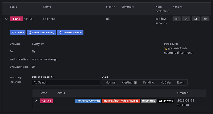

I suspect the issue here is that log is not being returned as a label from Loki. Here I have an example of a Loki rule I created that matches test1="hello", and it returns two labels: test1 and test2:
Do you see log as a label like I see test1 and test2?
Hi George,
Please find the query I’ve used and let me know if the condition needs to be updated as well in order to displayed the data properly -
Thanks,
Eugene
I think there has been some confusion here :slight_smile: Please use your original Loki query but show me the result of the Preview button like in my example. I want to see what labels are returned by your query. You might need to make sure the query returns data if it returns No Data.

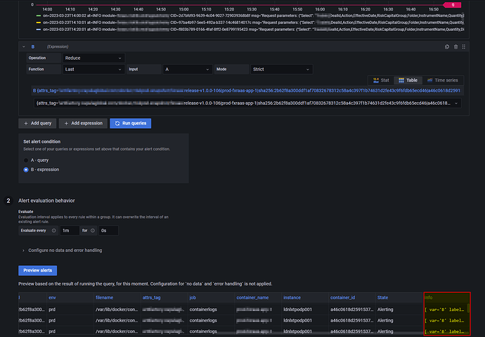

It appears that log is not returned as a label in fact though please correct if the steps are accurate and/or if needed to update the alert configuration -
Thanks! If you change the expression B from a Classic Condition to a Reduce and click Preview, is it still not a label?
In the meanwhile, I can ask the Loki team because I suspect there is something we need to change in the query for this to work.
Looks like it’s part of the Info column in the Preview, please find the details as follows.
[ var='B' labels={attrs_tag=<app_link>:release-v1.0.0-106|<app>|sha256:2b62f8a300ddf1af70832678312c58a4c397f1b74631d2fe43c9f6fdb65ecd46|a46c0618d259153766d25217e56845e30aa1597b398c7ff48c958a765d70546c, container_id=a46c0618d259153766d25217e56845e30aa1597b398c7ff48c958a765d70546c, container_name=<app>, env=prd, filename=/var/lib/docker/containers/a46c0618d259153766d25217e56845e30aa1597b398c7ff48c958a765d70546c/a46c0618d259153766d25217e56845e30aa1597b398c7ff48c958a765d70546c-json.log, hostname=<instance>, image_id=sha256:2b62f8a300ddf1af70832678312c58a4c397f1b74631d2fe43c9f6fdb65ecd46, image_name=<app_link>:release-v1.0.0-106, instance=<instance>, job=containerlogs, log=on=2023-03-23T14:50:01 at=INFO module=<module_name> CID=532270ad-6646-40be-9c69-064f0d47531d msg="Request parameters: {"Select": "TradeId,DealId,Action,EffectiveDate,<Group>,Folder,InstrumentName,Quantity,Direction,<Product>,<ProductType>,TradeCcy,CurrencyPair,Premium,PremiumPaymentCurrency,SettlementType,CallPutIndicator,Valuation,Barrier,BarrierStart,BarrierEnd,BarrierDown,BarrierMonitoring,SettlementDate,FarSideSettlementDate,ExpiryDate,FixingDate,FixingTime,FixingCity,PaymentAt,Price,StrikePrice,UnderlyingInstrumentName,ValueDate,Comments", "Where": "((UpdateTime>=DateTime(2023,3,23,14,0,5,\"Utc\") and UpdateTime<=DateTime(2023,3,23,15,0,0,\"Utc\") and <ProductType>.Contains(\"<Product>\") and SettlementDate>=DateTime(2023,3,23) and (Folder=\"TARUN_1\" or Folder=\"H278A\" or Folder=\"H278C\" or Folder=\"H278D\" or Folder=\"H278E\" or Folder=\"H278B\")))", "GroupBy": ""}" , stream=stderr, stream_extracted=stderr, tag=<app_link>:release-v1.0.0-106|<app>-1|sha256:2b62f8a300ddf1af70832678312c58a4c397f1b74631d2fe43c9f6fdb65ecd46|a46c0618d259153766d25217e56845e30aa1597b398c7ff48c958a765d70546c, time=2023-03-23T14:50:01.510273313Z} value=1 ]
