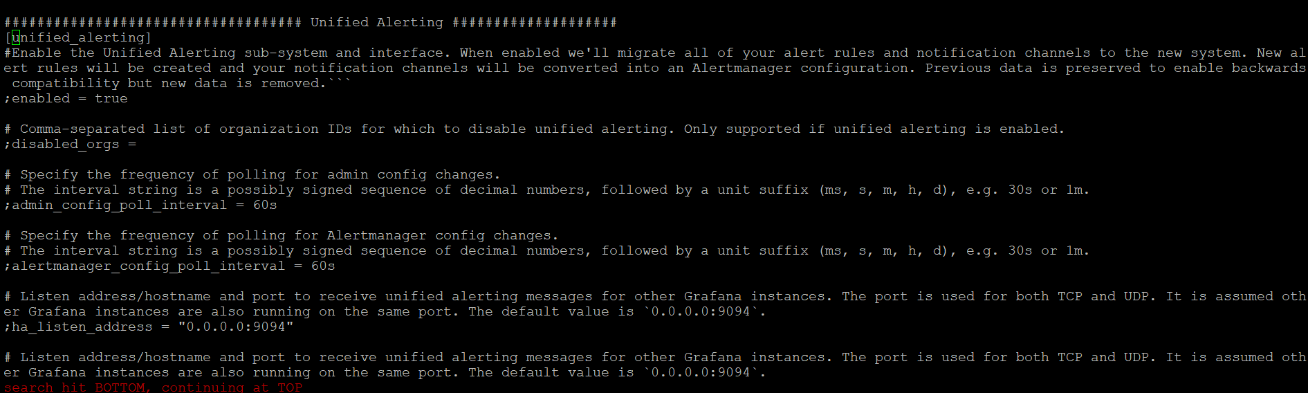

Did you update the configuration file as per the documentation? Can you show me the changes you made to grafana.ini?
in grafana.ini. I did not change for slack notification.
In latest version unified_alerting.screenshots is not available.

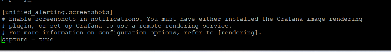

You need to enable screenshots in [unified_alerting.screenshots] as per the documentation otherwise it won’t work :slight_smile:
I enabled it but still no image.

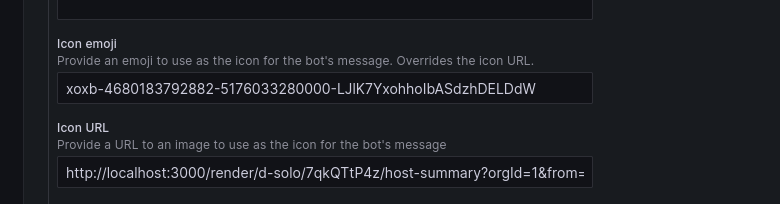

Is this correct?
Hi @georgerobinson.Thank you so much its working now for mail notification but for slack its still not working
@georgerobinson Where to add the bot token in contact point of grafana ui?
