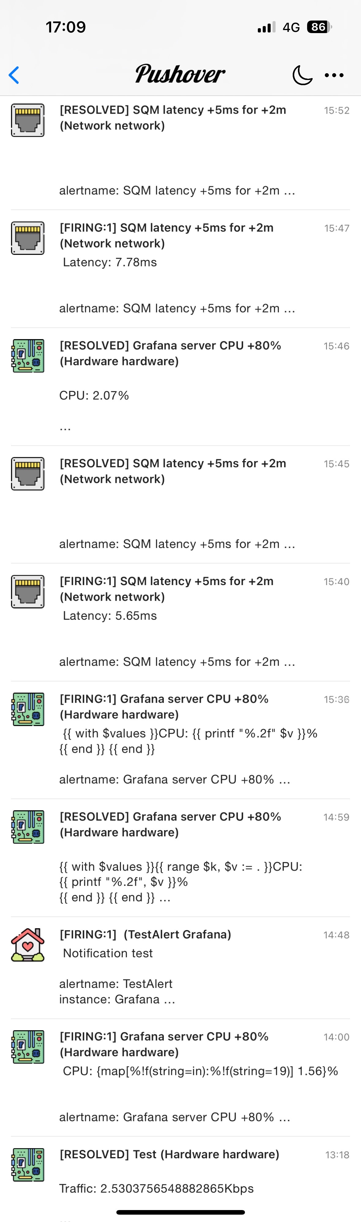

Anyway this works for the decimals but it returns me this weird query:
CPU: {map[%!f(string=in):%!f(string=19)] 1.56}%
using as message:
{{ with $values }}{{ range $k, $v := . }}CPU: {{ printf "%.2f" $v }}%
{{ end }} {{ end }}

Great thanks! This works finally:

I’m still developing it as you can see from these screenshots :sweat_smile:
But when it will be completed it will report all the alerts and values for firing and resolved issues.
If you’re interested I’m witing a “how to”, as soon as I finished I’ll send it to you. It’s not complicated but a bit tricky.
My goal is read only a iOS push notification with the value and if I open the push I get all the details/silence url/dashboard id.
And I don’t know why for some resolved alerts it reports me the value and not for some others.
