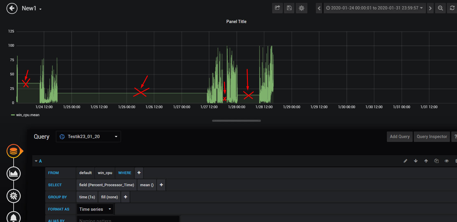

Good day to all! I am interested in how I can remove the line that connects the two graphs? Suppose I write the processor load data to the database and display them on the graph, after which I turn off the data recording in the database and resume after a while. The graphan automatically connects the two graphs with a line, but I need to clearly see the gap and the fact that data for this period were not written. Attached a screenshot. How to do it?
Try to change the fill or group by clause.

Thx solution:GROUP BY time($interval) fill(null)
