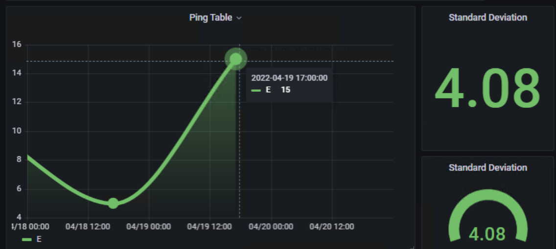

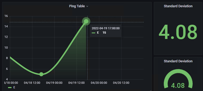

I would like to plot the timeseries and in legends (or somewhere) see the standard deviation as 4.08.
option 1
create a hidden dashboard variable named standarddev with
SELECT STDEVP(events) as value FROM pingtable
Then for you data source query do
SELECT
$__timeEpoch(hit_date),
events as value,
events metric,
$standarddev deviation
FROM pingtable
ORDER BY hit_date ASC
results in (painful on the eyes) with using Legend Mode/Legend Values of Last
option 2 (best option) as it can also scale cleanly with more values.
one time series with gauge or stat (both use sql statement
