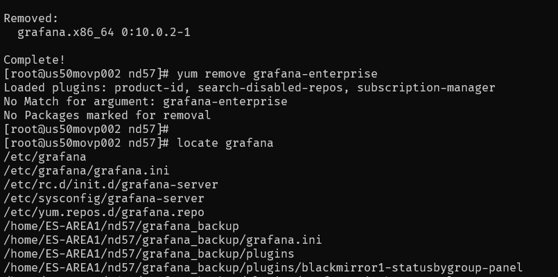

@davidallen5, thanks so much for the reply!! :pray: I did just as you described and it left quite a few remnants on the server that did not exist prior to me installing grafana yesterday. I’ve exported the text from the terminal to show you but it won’t let me upload a text file, only a photo, so I’ve attached screen shots of the locations that were left behind after removal. Note: nd57 is me and grafana_backup directory is where I put our grafana.ini and plugins for safe keeping while I try to get this server cleaned up and Grafana installed from scratch again.
I will try removing everything again manually and doing another install now that I’ve done yum remove as you suggested and see what happens. My goal here is to get this server to a point where I can easily do a install/upgrade/update Grafana to the next version when it comes out. This historically has not been easy to do on this server and it’s likely due to how Grafana was installed & setup to begin with; hence my wanting to start from scratch.

@davidallen5 I finally won!! :tada:
  1. After doing yum remove grafana
  2. I manually removed the above remnants
  3. I then ran sudo yum install -y --disablerepo=docker-ce-stable --skip-broken https://dl.grafana.com/enterprise/release/grafana-enterprise-10.0.2-1.x86_64.rpm again
  4. I witnessed log messages from the postinst script as I thought I should :tada:
  5. Was able to start Grafana as I desired with systemctl start grafana-server :tada: :tada:
Thanks for the guidance on this!!
