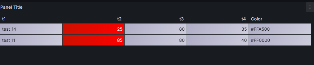

config from query transformation
along with
but this will require something like this in your datasource query (this is a sample)
with src
as
  select 'test_14' as t1, 25 as t2, 80 as t3, 35 t4 union
  select 'test_11' as t1, 85 as t2, 80 as t3, 40 t4
select *,
  case when t2 > t3 then '#FF0000'
   when t2 < t4 then '#FFA500'
  end  Color
 from src
Thank you for your reply. I tried what you have shown, but only have 1 transform, and it didn’t work. It always used the last color in the dataset, for both records.

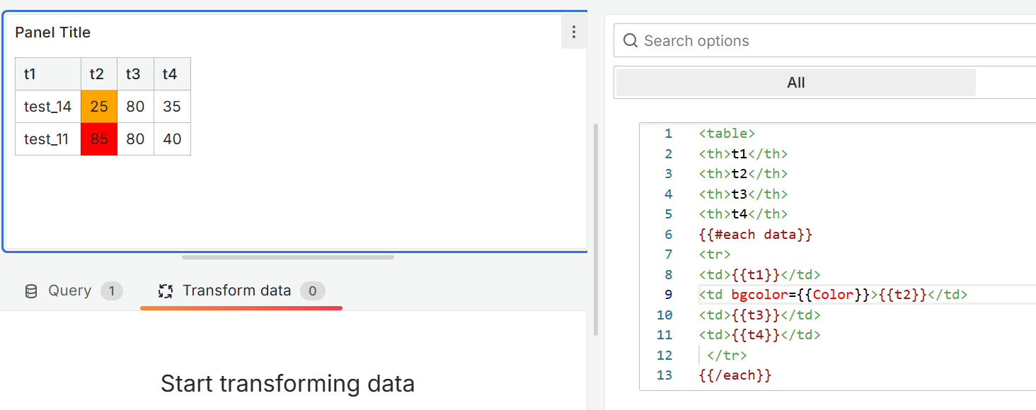

looks like there is a bug there if you choose All Values. your next approach would be business text plugin using html

Yes what I am hoping to do, is set the color for each record, based on the result of the color column. The first record should be orange, and the second record should be red. But that is not happening.
So the other alternative would be building an HTML table using the another plugin?

docu
