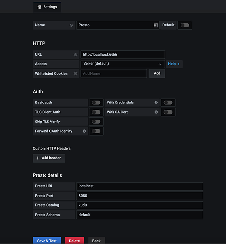

I have installed the plugin from the above link and when I want to add a data source as shown in the image below, I encounter an error:
HTTP Error Bad Gateway
When I put “Access” on the browser, I don’t encounter any errors, but when I use this data source in the dashboard and query Trino, no data is displayed in the output.
(Our trino version is 377, and I also use basic auth. for security reasons, I can’t add a picture of my exact datasource settings.)
