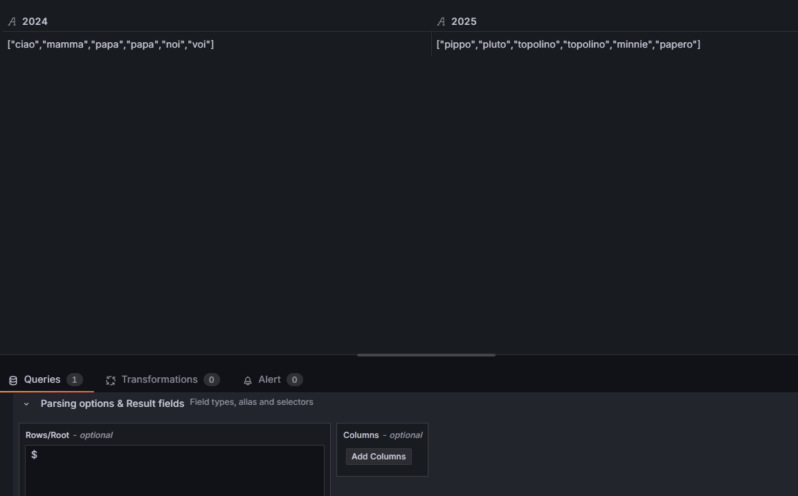

Using your data and the Infinity Datasource using the inline feature with your data
Here is what I get using $

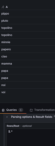

And here is what I get when I use $.*
