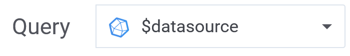

Don’t modify query. You need to select that datasource variable in your query editor:
Amazing ! Thanks for the advice !
