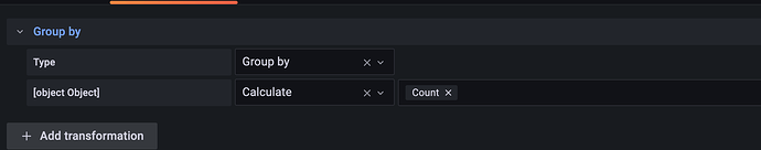

Im trying to group by and count items on a table (to be displayed on a pie chart). The data is gathered via an API call using infinity.
I have been able to “group by” each item, but I am not able to get a total count of each item. The group by just gives me a count of 1 for each item. I have also tried to do some other transformations, such as extract fields, but the data is not doing the count properly…
Does anyone know how to get a correct count?
I will include a screenshot of the data I’m trying to count. The result should be:
Physical Desktop count = 3
Physical Server count = 1
Virtual Server count = 1
Thank you,

@yosiasz Thank you so much for your reply and I have solved the issue with the help of your reply above.
I want to also apologize for not being able to provide any data since the data sits on an API repository that I access with authentication. Anyways, now to the solution.
Since I am using infinity as a data source to hit the API, I have selected the data I want to gather. In this case, the type (form type) of endpoints and I needed to get a total count. I tried to use transformations to get the count, but I was not able to get a correct count.
Turns out that I need to have an empty string as a second column in order to use transform to Group by, and then calculate a count. Once I added the second empty column I was able to easily group by and calculate.
