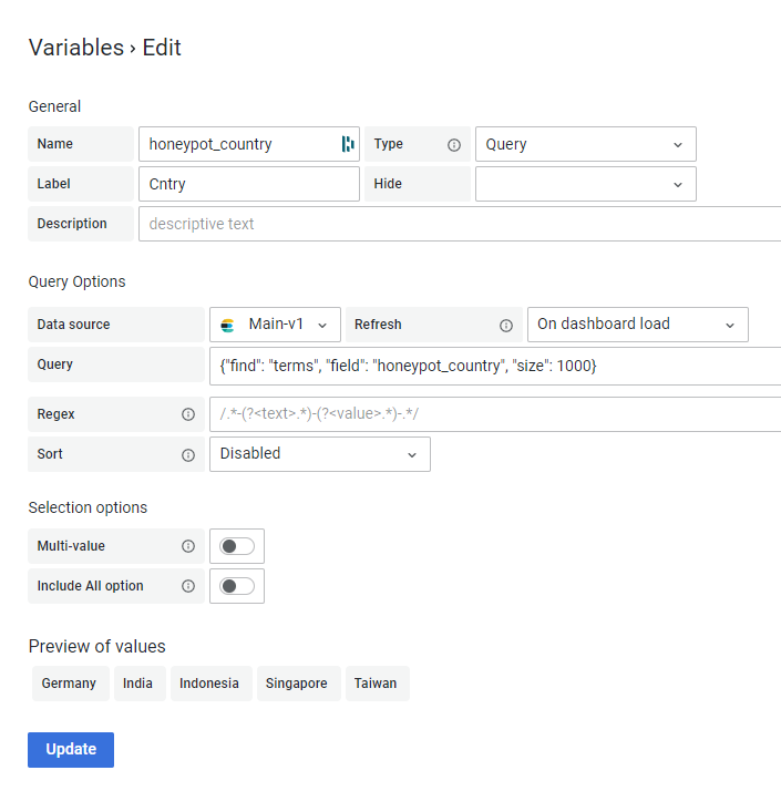

am currently using Grafana v9.1.7 and ElasticSearch 8.4.2
What I’m trying to achieve is to create a dashboard that can filter the data by country. I have a keyword field named honeypot_country (it’s a string that mapped into keyword in elastic). When this filter is selected, it should only provide set of data filtered by that country
I already tried to create a variable query to filter these data. But it doesn’t filter as I want to. So, I hope anyone can help me with this issue. Thanks

And this is how I do the query using ElasticSearch. I didn’t write custom any lucene query for most of the visualization
You would need a where clause that uses the country variable otherwise grafana cant automagically use that filter
Hi @yosiasz , can you help me providing an example?
check this out
Hello! Thank you for the link that you provided. Unfortunately, adding the query makes the data doesn’t appear properly. I would like to filter by country and sometimes see the data without the filter. Is it possible?
Works like a charm! Thank you very much for your help! :blush:
