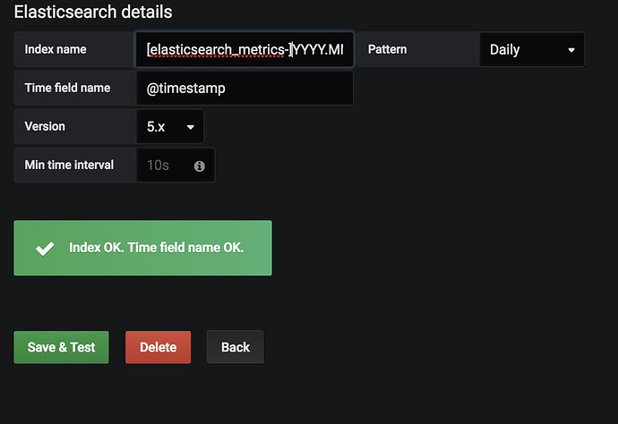

I hava the same issue, no data found! It is confused… every config is right…
I have know the reason, the index pattern is not right for me, so no data found, the following index pattern is not right:
The following is right(please note the [ and ] char):
The solution for me was to put an asterix after my index name as so: index-name* and use the query pattern below:
