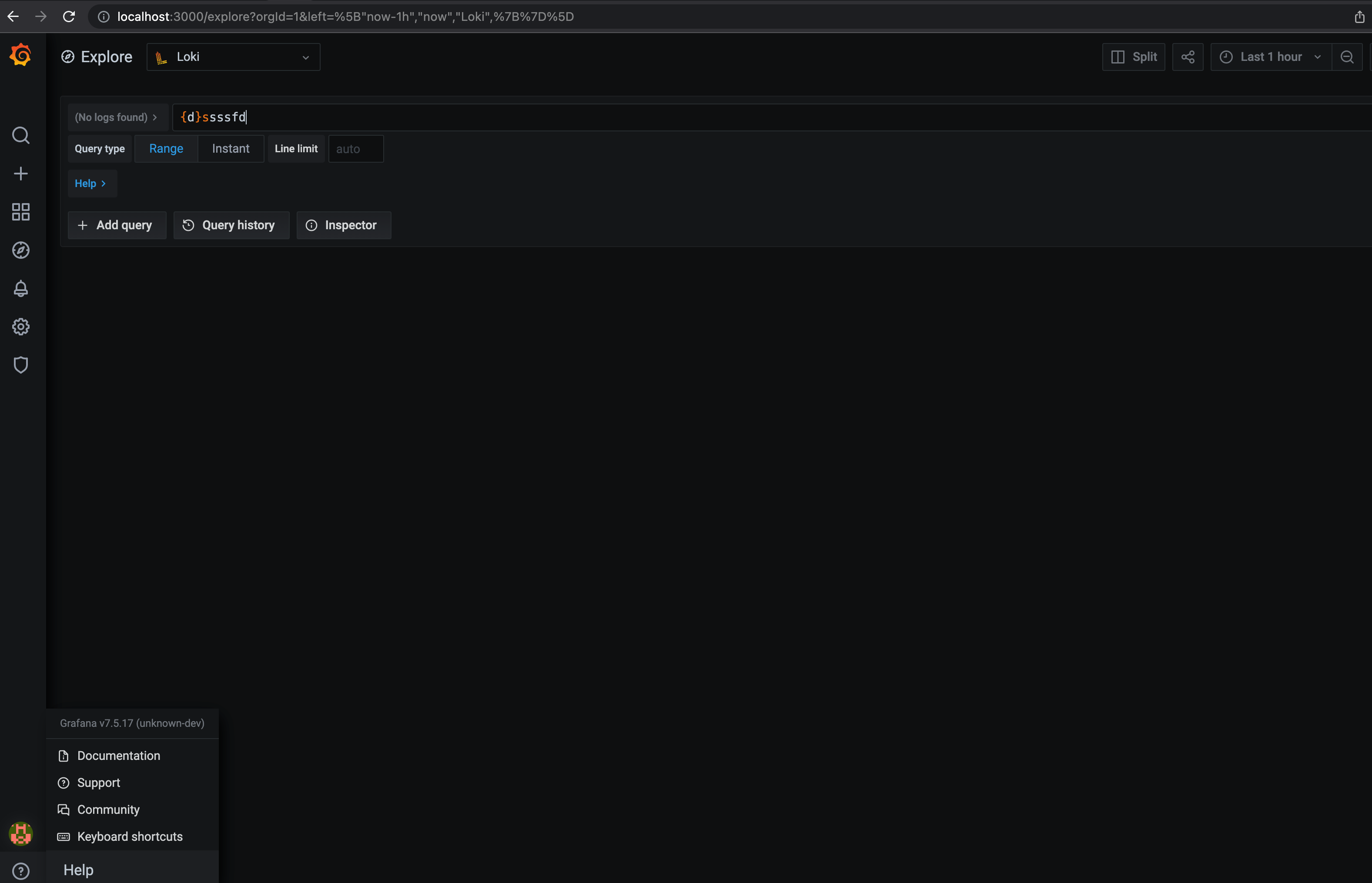

I was trying to build and run Grafana v7.5.17 directly from source code for the fix of loki query input issue with Chrome. However, the issue is not fixed by this way.
Source code: Release v7.5.17 · grafana/grafana · GitHub
Fixes applied: [v7.5.x] Chore: Update slate and related packages (#54566) by kaydelaney · Pull Request #55688 · grafana/grafana · GitHub
I tried on both MacOS and Ubuntu,
the command I used on MacOS:
make build-docker-full
docker run -d -p 3000:3000 grafana/grafana:dev
The command I used on Ubuntu:
docker build --tag grafana/grafana:dev -f Dockerfile.ubuntu .
The result I got (same on both os):
If I run the source code using commands in the developer-guide, the fix works. So I checked the source code in the running container, and found it was the v7.5.17 code with the fix in.
If I run the image from docker hub, everything works fine.
I’m wondering why local build does not solve the issue? Did I miss something? What is the recommended env for building image from the source code?
I’d appreciate it if anyone can help.
btw, there’re building errors with the original Dockerfile and Dockerfile.ubuntu from source code, I fixed it by move the “RUN go mod verify” after the “RUN go run build.go build”. This should be irrelevant with the problem I met though.

Hi, thanks for replying. The docker file I use is Dockerfile.ubuntu showing below. The only changes are the RUN go mod verify which is placed after go run build.go build and the Run yarn check --verify-tree. The build has 0 error with this docker file. (Sometimes I met the following error, every time the package is different, the build could succeed after a few tries)

Hi, vendors~app.xxxxxx.js file is the only different file from official image after local build. Replace this file with the one from official build can solve the issue. However, this is not a solution in my situation.
There should be sth wrong during the build process, because this issue can be reproduced every time for local build on Mac, Ubuntu and CentOS.
What is the right way of building source code locally? I appreciate any instructions or correctness of my build process posted before.
