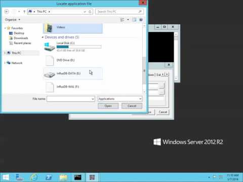

Another detail I forgot to mention. I installed my grafana mostly by following these methods,
the only difference that I did, is that I installed grafana via “Local System account” (youtube video at 3:27) :
