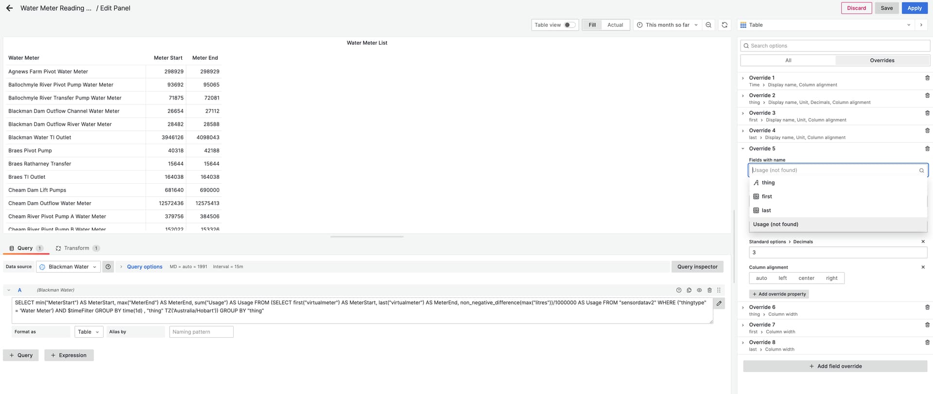

    We have a query/table combination that has been working for a couple of years. Since the last upgrade a query column has disappeared from the table.
    The table to work as it always has. Two things stand out - the Overrides pull down does not display field names as the query in Influx shows them. You will notice the column Usage is displayed as not found although the query produces it.

Thanks for the reply. It appears that the latest release of Grafana OSS fixes a previous issue with the treatment of certain InfluxDB queries. We were able to make corrections to a number of dashboard panels and our problem seems to have been rectified.
