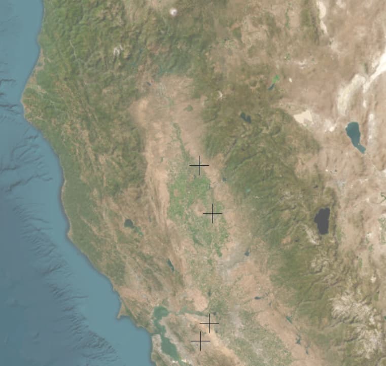

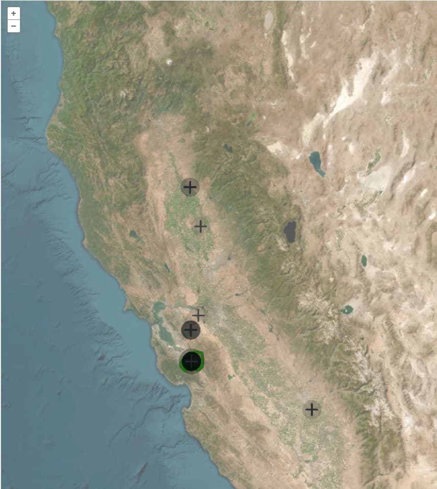

I am using Grafana V12.0.1(OSS) after upgrading from V10.4.19(OSS). My Geomap is showing a grey circle as background for svg icon (/img/icons/unicons/truck.svg). I even tried using custom svg file(with transparent background in svg) but still I am seeing background grey color(which I do not want as it looks messy). Attaching image for reference. there can be more than one point closely located.
in Grafana v10.4.19
in Grafana V12.0.1
Am I doing anything are wrong? Any Help would be appreciated.

since v12 Geomap uses WebGLPointsLayer from Openlayers framework for marker datalayers. It renders a circle with webgl shaders, and the svg icon is somewhat alien thing on top of it. You can’t do much till the Grafana labs/OpenLayers arrange the circle sizing (hiding)
