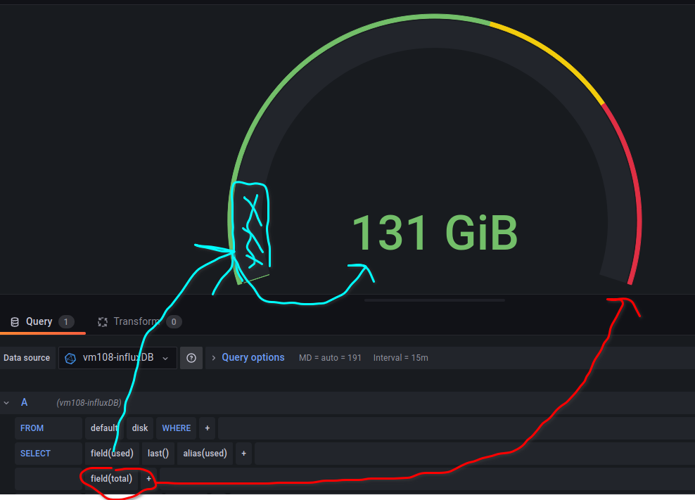

Hello
i have been reading to get Max Size i have to the field(Total)
The Problem the blue part is still at the bottom on the left side.
what did i wrong?
have a nice day
vinc
Hello
what did i wrong?
have a nice day
vinc
Are you sure that the 131 GiB value being returned is NOT a string? More here.
Hello @grant2
i think same problem - how do i find out it is a string or not? and how to modifiy it.
The Value came from a telegraf input into the influxDB 1.8
have a nice day
vinc

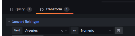

What language did you use for telegraf. Did u convert that unit of data to int when writing it to influxdb?
You can also try this…
