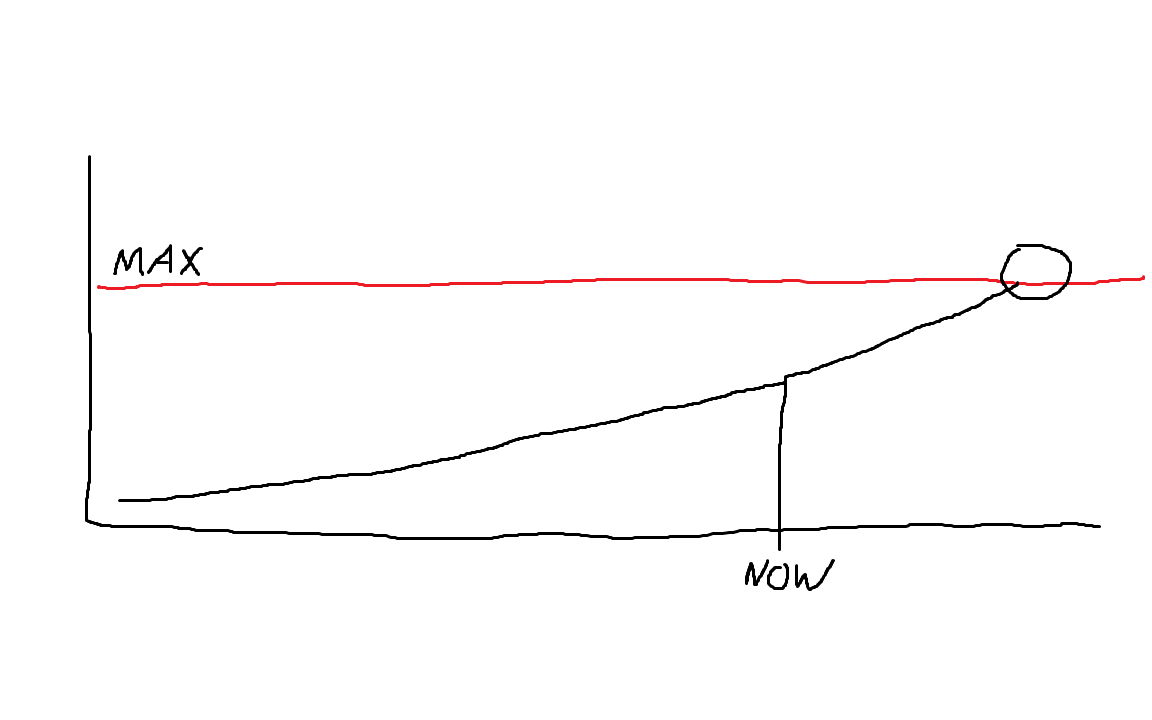

I have multiple network switches that I have used ports and open ports for several years. I would like to forecast a potential date when the switch ports will be exhausted based on previous trend data
Something like the following but I cant figure out how to continue a trend to the future.

I was reading that initially and trying it out… but I could not get the graphs to extend past the current date… Even when I did current year in the time picker. It “appears” that it stopped the graph from moving into the future . I have been trying to read up on that function (and why I went with influx is I thought it would do what I wanted or the mysql window function in 8.x)
