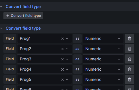

The column names of this table
Hi
TimeDate, Prog1, Prog2, Prog3, … Prog60
all the Prog# columns are numeric values
the TimeDate column is the datestamp of the event with one record per 10 minutes.
I think I have it working now as required, but my SQL is very poor and I dont seem to be able to integrate the Grafana function
$__timeFilter(TimeDate)
so I am still using a fixed time to prove the concept.
