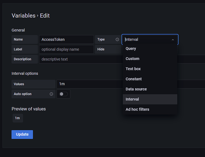

I have gone through the documentation. We can configure a variable to be hidden.
But as you know, usually Access tokens are valid for a limited period of time.
And a variable can be of either types, interval type or query type.
But there is no option like which we can configure the variable to query the output every 1 minute.
We can achieve the variable output to be updated on time change or dashboard load if we configure it to be of query type.
But not all together, if there is anything I am missing, please correct.

I solved it by setting the variable to update on time change instead of the Dashboard Load.
And setting the Variable as hidden. This way the key generated will not be visible to the users.
So whenever we load the dashboard it will need a time input to load the charts and tables, so the time change is also triggered, which is triggering my variable and generating the token key.
This output from the variable is then used for the authorization of the GET or POST api I am invoking to fetch the data I need.
Hope this implementation method helps someone.
