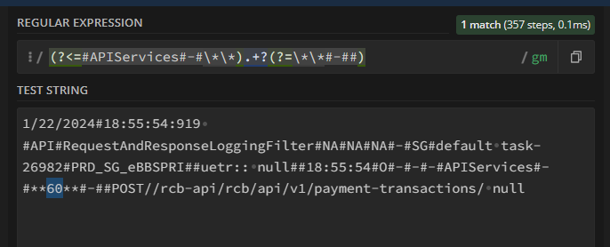

1/22/2024#18:55:54:919 #API#RequestAndResponseLoggingFilter#NA#NA#NA#-#SG#default task-26982#PRD_SG_eBBSPRI##uetr:: null##18:55:54#O#-#-#-#APIServices#-#**60**#-##POST//rcb-api/rcb/api/v1/payment-transactions/ null
From the above log line, i want to extract 60. which is transaction posting time taken.
I’m currently using below query, but not getting the value as expected.
message:(#O#-#-#-#APIServices#-#(\d+)#-)
@sowdenraymond - Thanks for your reply. We’ve tried this website but this query is working only in the regex website and not in grafana. Grafana doesnt extract any data using this regex. when I was reading on this, found below response in one of the thread.
@yosiasz - Go, hence Grafana uses RE2 regexp which does not support a lot of things. Check it out here: Syntax · google/re2 Wiki · GitHub .
I had the same issue, tested on regex101, then the pattern did not work in Grafana, then learned that RE2 and PCRE2 are two different things.”
