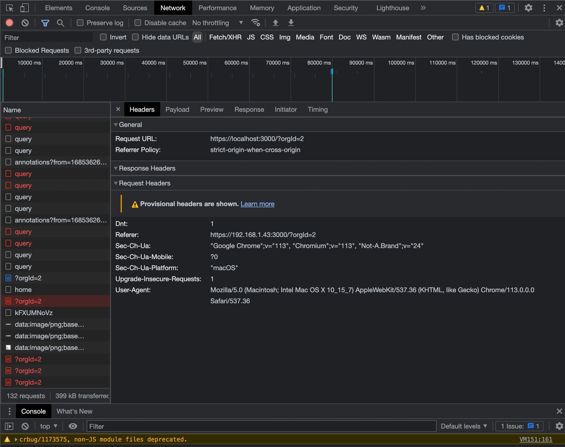

but when I access Grafana via IP of the server where it is installed on - 192.168.1.43:3000 only one organisation is OK:
the moment I click in the menu on the second one, it changes the address to community.grafana.com
and of course it fails
What am I doing wrong?

good request:
bad request:

hi @homonto
I tried to reproduce your setup but I am missing something and so I can’t troubleshoot the problem.
Can you open a new issue in our repo instead? Please add the info you already provided. Once you opened it, I will forward it to the engineering team that deals with these kind of issues.
Thank you
