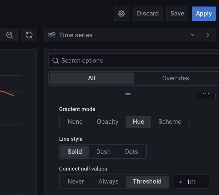

Do not show connect values over 1 Minute
I would like to do interface statistics, but I have the problem that I have no data from time to time.
I now want that when there is no data, there is a gap - which is not happening at the moment → I guess because I need “difference” as I have to subtract the current value with the previous value to see the utilisation of the interface.
I collect the value every minute.
So, it should not be connected if the current and the previous value are more than 1 minute apart.

Did you play around with the Connect null values threshold setting and see how it affects your results?

Hi,
yes, no change. Because the Value is never null.
So if I have a Port with value 500 at 07:00 and with value 900 at 07:23 → the value is 400 and not null.
