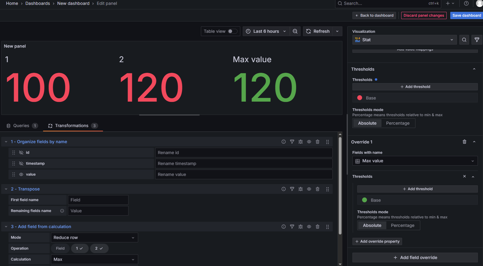

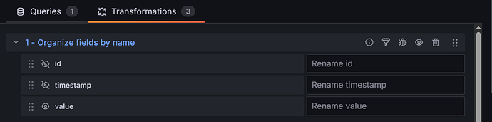

Hello @j0jje, I tried based on the min/max value maybe it will be helpful for you. Using Grafana transformations, first i used the ‘Organize fields by name’ transformation to hide the unwanted fields not necessary( optional transformation)
then use transpose transforamtion for all values in one row

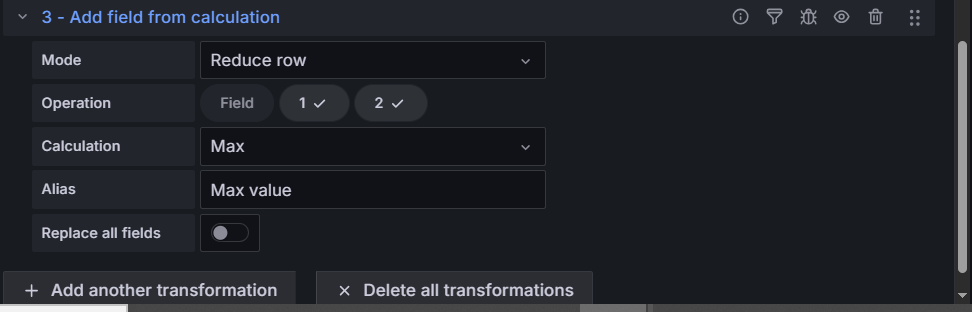

Then finally, use ‘Add field from calculation’ to calculate the max value in the row
Now you can use ‘Add override’ and set the override on the max value field it will work for you like this…
