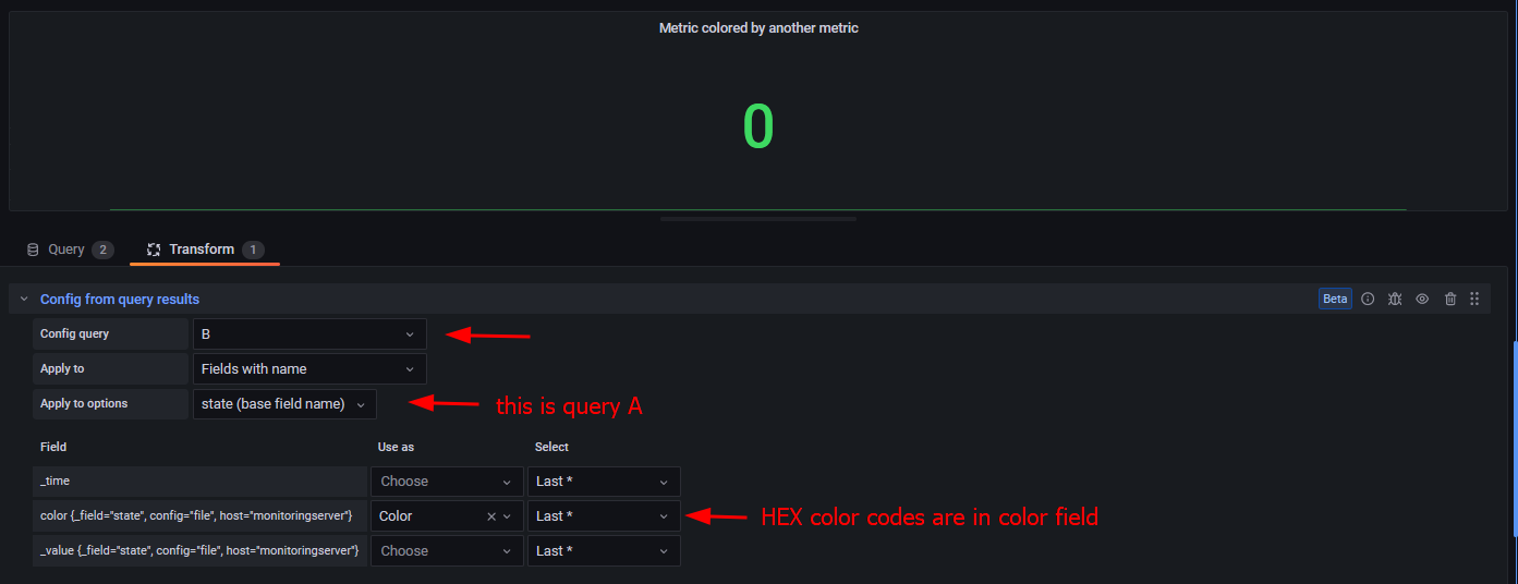

Grafana queries:
Grafana Transform:
Here I am using query B to configure values of query A ( i.e. state (base field name) ). HEX color codes ("#3dd961" and "#fc1c5b") are stored in column "color" and this column is used for coloring values of query A.

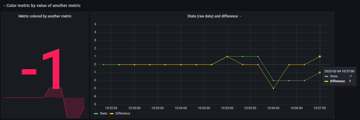

Result:
Pictures
State is unchanged (State = 0 , Difference = 0) → green color
State has changed (State = 1 , Difference = 1) → red color
State is unchanged (State = 1 , Difference = 0) → green color
State has changed (State = -2 , Difference = -3) → red color
State is unchanged (State = -2 , Difference = 0) → green color
State has changed (State = -1 , Difference = -1) → red color
Hope this will help. :slight_smile:
