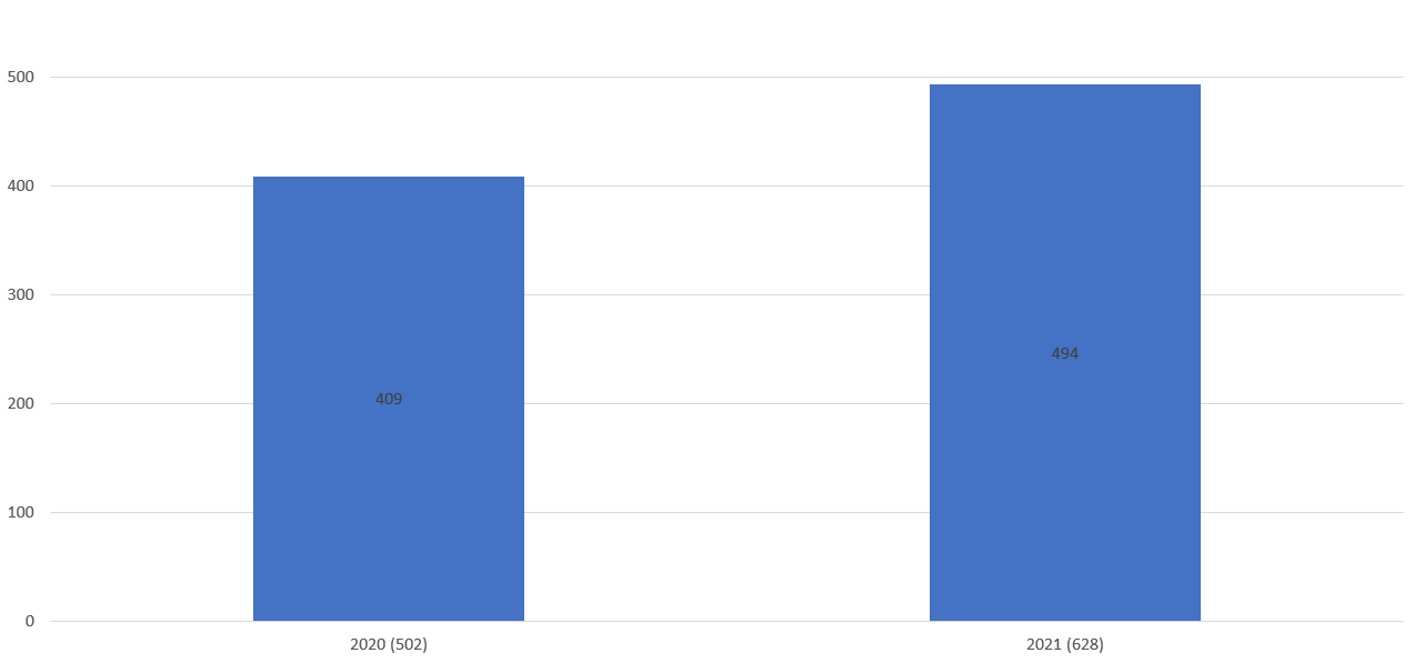

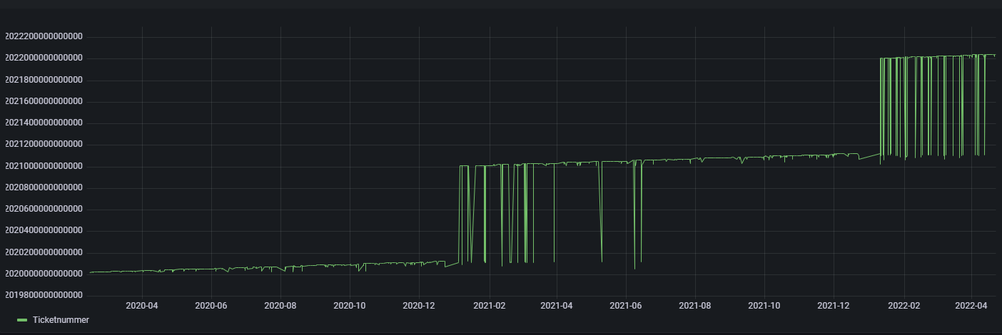

At the moment I get the following output.
The output should look something like this.
I guess I have to work with the transform function here, however I don’t know exactly how, does anyone have a tip for me?

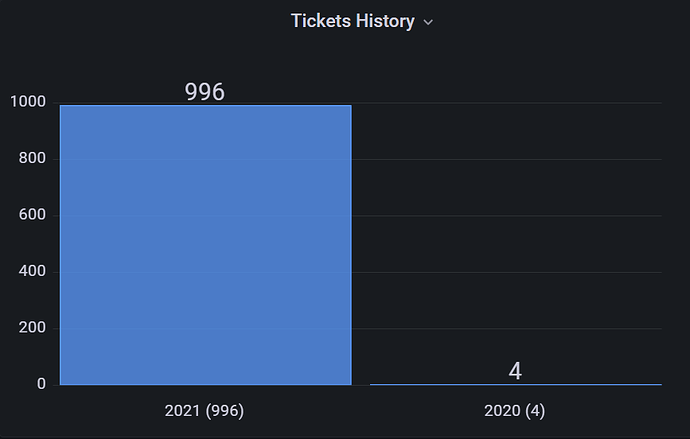

in sql server
SELECT  count(1),
        concat(year(geshloschen),' (', count(1) ,')')   AS metric
FROM tickets
GROUP BY year(geshloschen)

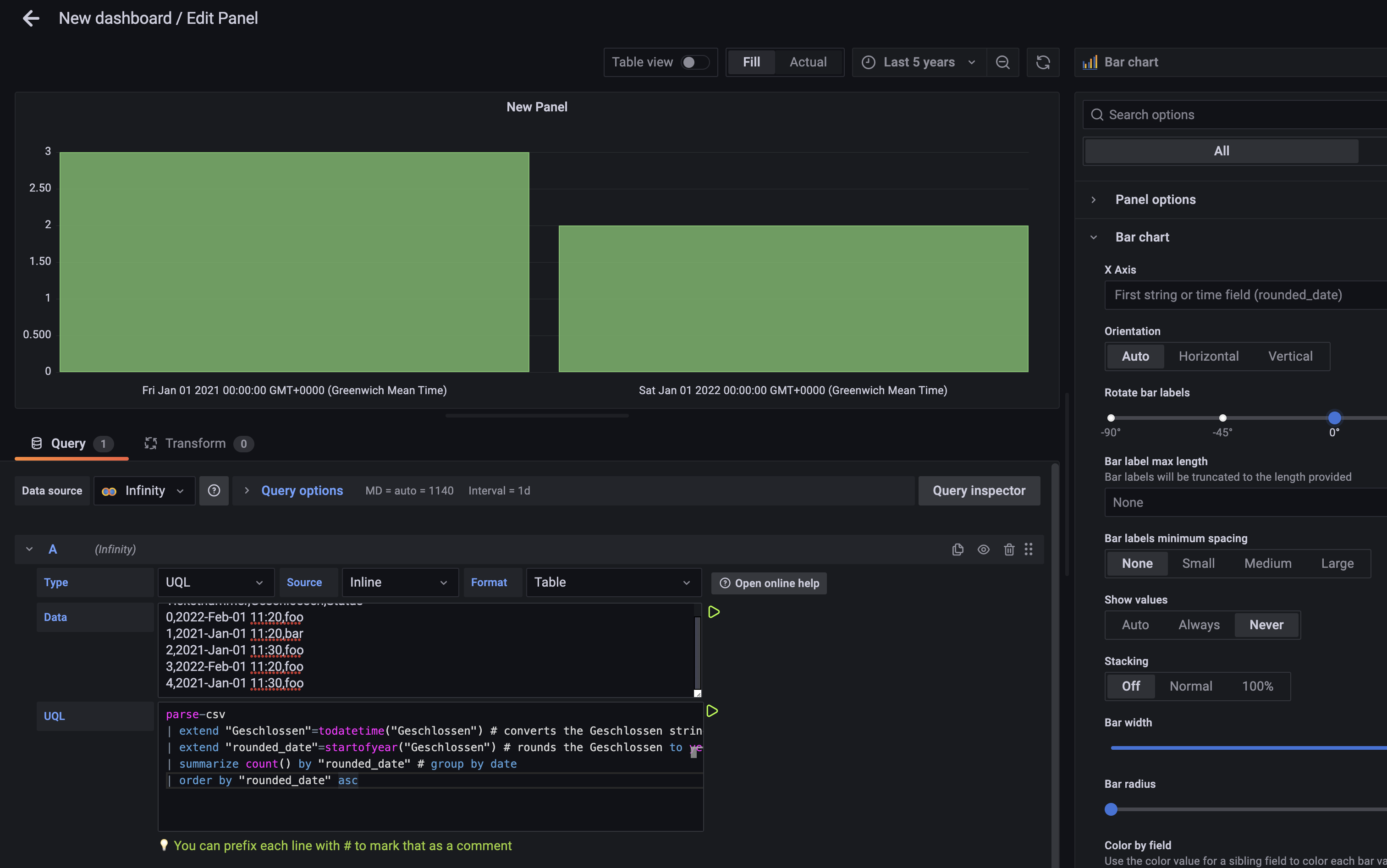

If you are using Infinity datasource, you can use the UQL to do this for you.
The UQL query I am using
parse-csv
| extend "Geschlossen"=todatetime("Geschlossen") # converts the Geschlossen string to actual date
| extend "rounded_date"=startofyear("Geschlossen") # rounds the Geschlossen to year
| summarize count() by "rounded_date" # group by date
| order by "rounded_date" asc
