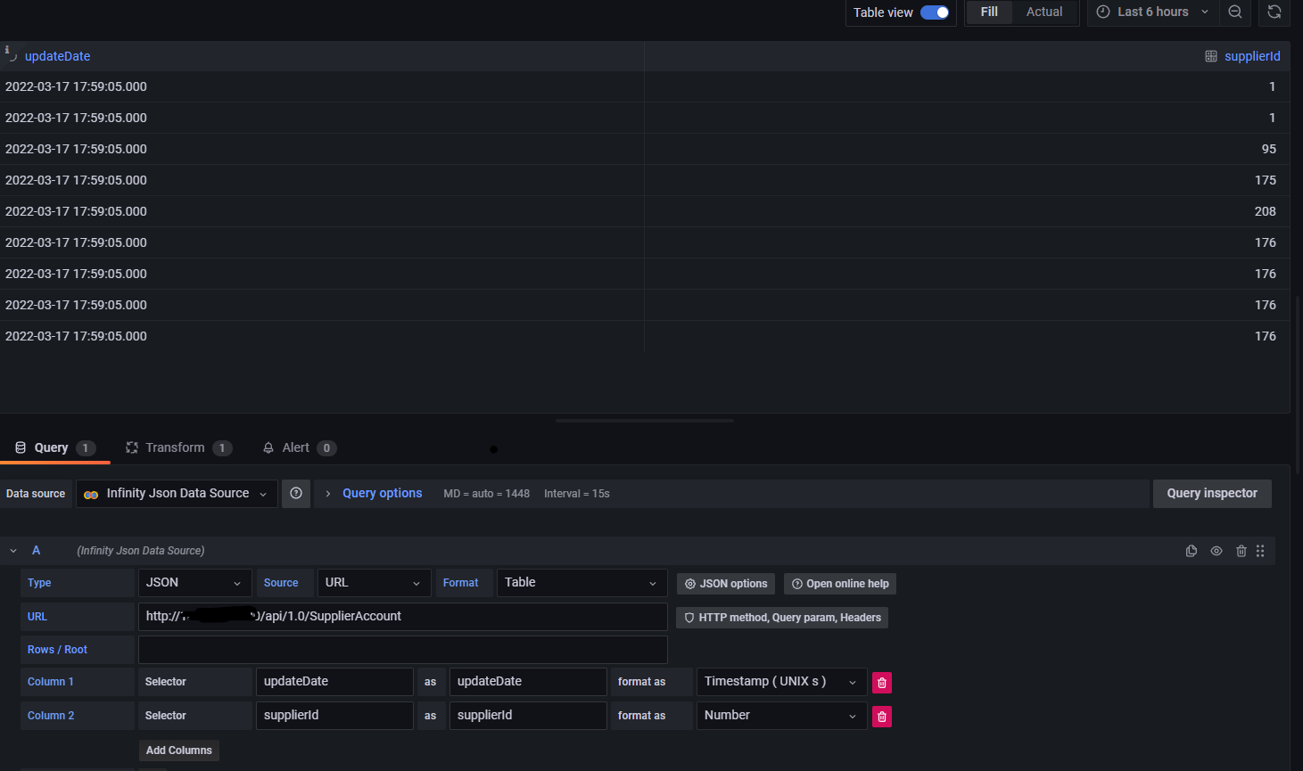

Yes, it has timestamp. I am sharing the table view
Also, this is the API response.

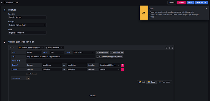

When I try to create an alert, I am receiving the below error

Use latest version of infinity with backend parser. For the alerts to work, it needed backend support

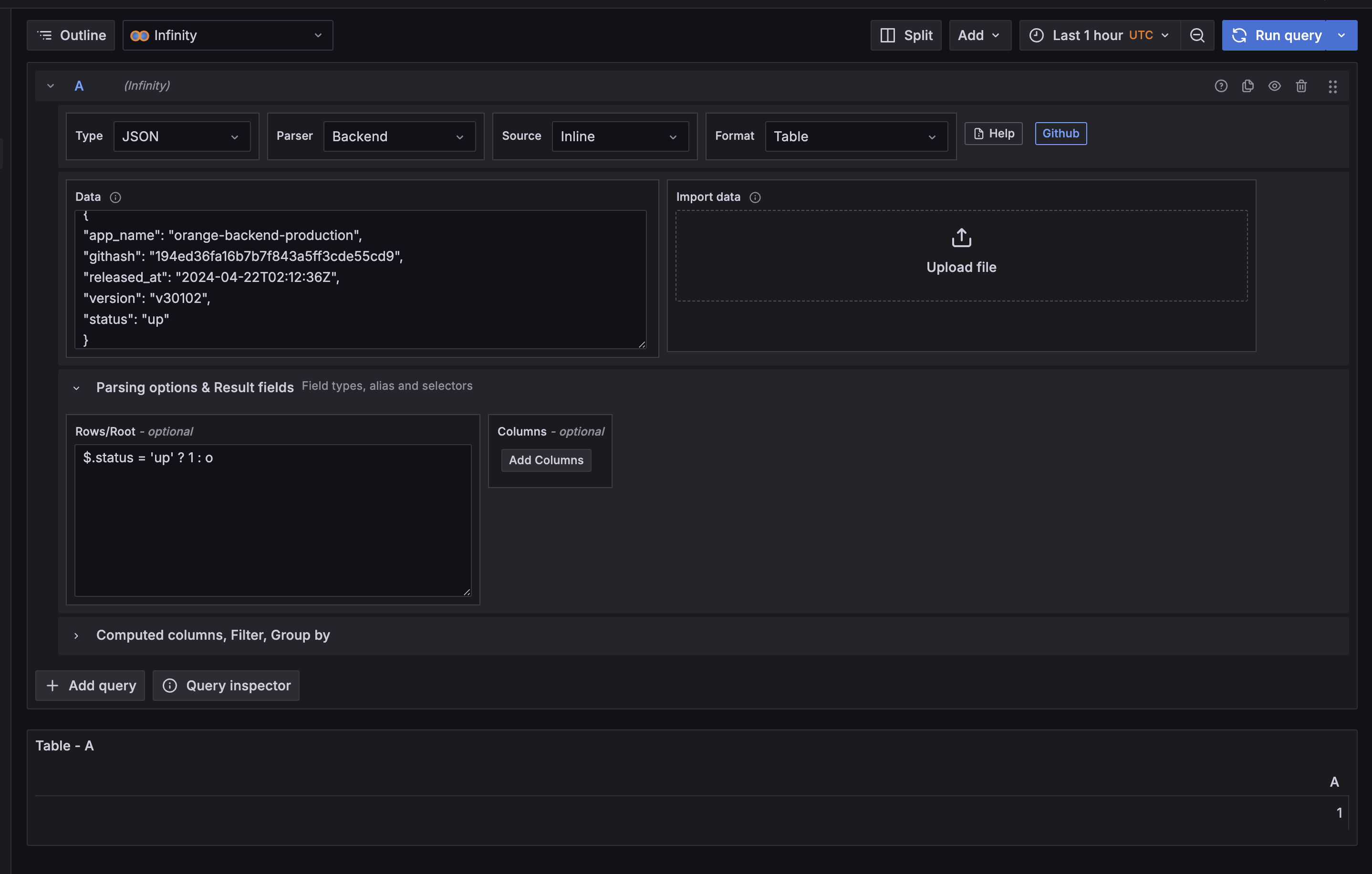

Is it possible for one to use Backend Parser to create an alert where the JSON looks like as shown below, and we can alert on status being down? I tried the usual Value Mappings features of Grafana which works fine for converting up to 1 and down to 0, but only dashboards, not for alerts.
In other words, if we use Backend Parser for alerting (which we must), and we must alert on numerical data, what’s the trick to converting Up to 1 and Down to 0?

You can use the backend parser and jsonata
when you have array of data you can use something like below
$map($, function($v){
  return {
     "app_name"   : $v.app_name ,
     "up"         : $v.status = 'up' ? 1 : 0
