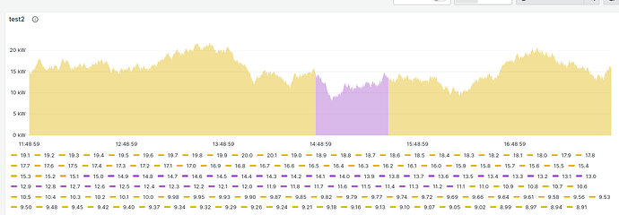

My bar chart should have a different color depended on the sun attitude -
How are you trying to achieve it?
- In “color by field” i set “sun attitude” from the sun and moon plugin.
- I set Value mapping to 11-15 and color to purple.
What happened?
The bars keep yellow, despite the sun is between 11-15 ° -
What did you expect to happen?
Here as datasource Grafana with Query type random Walk was used. The bars are purple, as they should be. -
