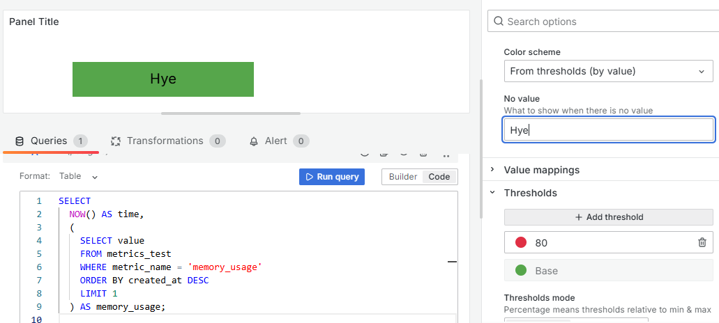

->Modify your SQL query so it always returns the field (even if null) using COALESCE()
->In the Canvas panel, bind the field which displays “No Data” if the field value is null, otherwise shows the field value.
