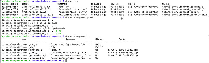

My next problem is: the sample application doesn’t work. I followed the first 5 steps up to here:
I think the two lines should show UP instead of EXIT:
tutorial-environment_app_1 /bin/sh -c /app http://db … Exit 2
tutorial-environment_db_1 /db Exit 1
In any way, when I try to access the sample application via pi-IP-adress:8081 the page is not available.
