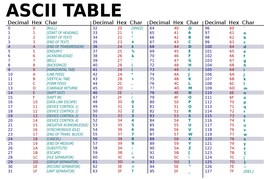

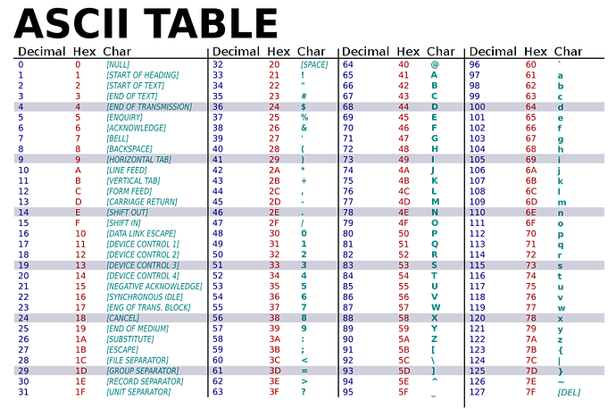

I’m assuming the %2B is just a replacement for the + sign? So you can’t put a + in an iframe/html call.
Yes,%2b corresponds to the hex code of the + symbol in the asci/utf8 encoding, but I do not know why this is done in this way
