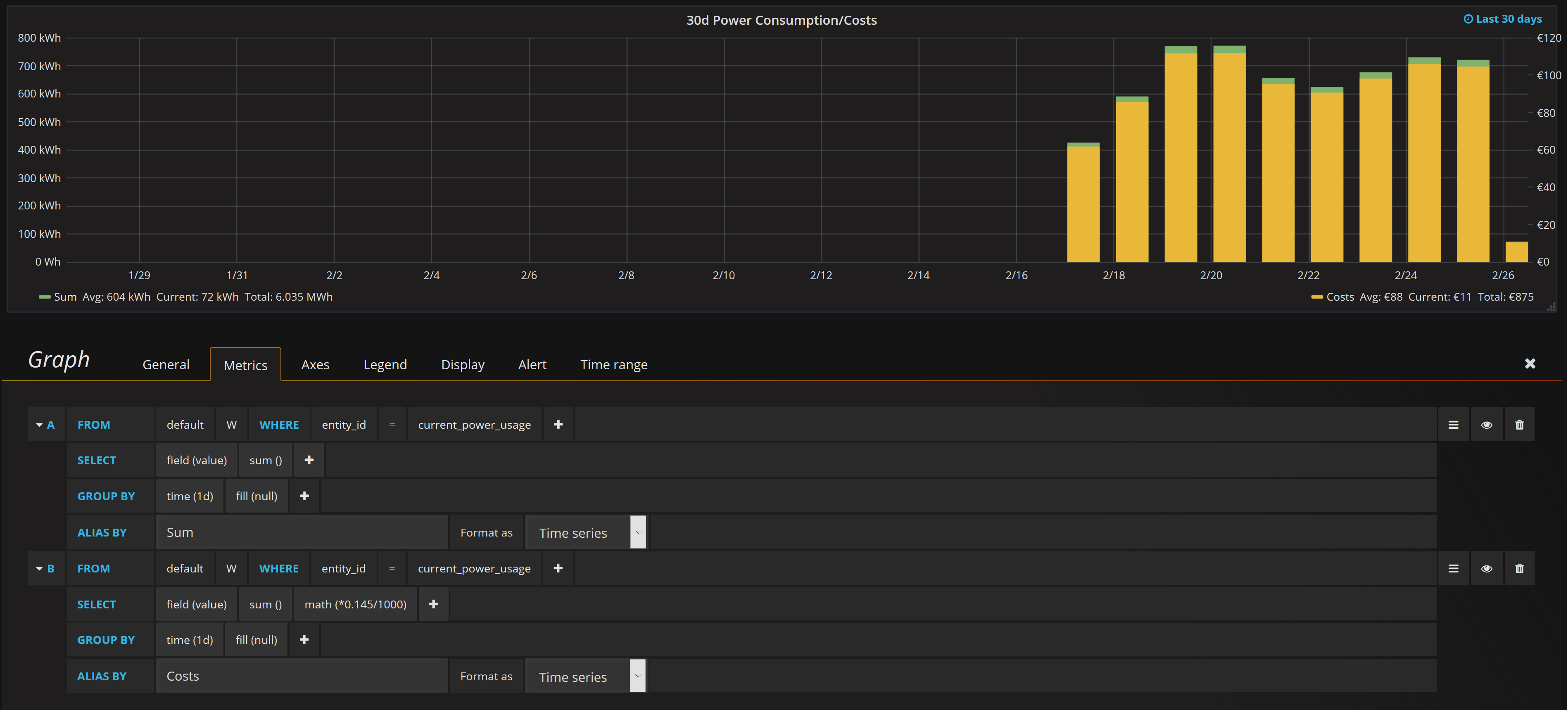

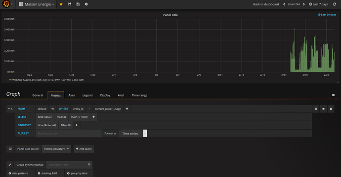

I would like to know if it’s possible how to calculate the daily power/coast consumption of my ‘tp-link HS110’ switch.
This is what i have done so far:
when i had the 1 day interval it give me wrong values.
I don’t understand how to make it work, i’m french math dumb lost in translation.
Any kind of help would be awsome.
Thanks
Hi,
Could you please specify what measurement and unit are written to influxdb and how often, what you expect to be the result in Grafana and exactly why that is wrong. Also, if you do a manual select against influxdb do you get out what you expect? And is at least one point written correct, otherwise there may be a problem on the way in.
Marcus
Hello, thank you for your response.
The measurement and unit written to influxdb are watts in current use, the value refresh by itself regularly.
The value i’m getting from my current watts usage in influxdb are true and they are the same in the offical app from my power switch.
I would like to group this values to display the power usage per day with ‘bars’.
Unfortunatly i don’t understand how to group the watts power usage per days, has shown on the above pictures when i had the ‘1 day group by interval’ the values i’m getting are wrong.
Thanks.
How about group by time(24h) and select field(value) and use sum aggregation instead of mean().
Marcus
Thanks ‘mefraimsson’, the Bars seems to be more legit now.
I will try to edit the unit axe to display the proper value.
I think i miss some math in the process, the average should be around 3 kw per days, not 600 kw :exploding_head:. Do you know how to apply this change.
Thanks.
If the average should be around 3kw per day I guess you’re displaying the wrong values in the graph. The average is basically calculated in browser based on total / number of points, i.e. 6035 / 10 = 603.5.

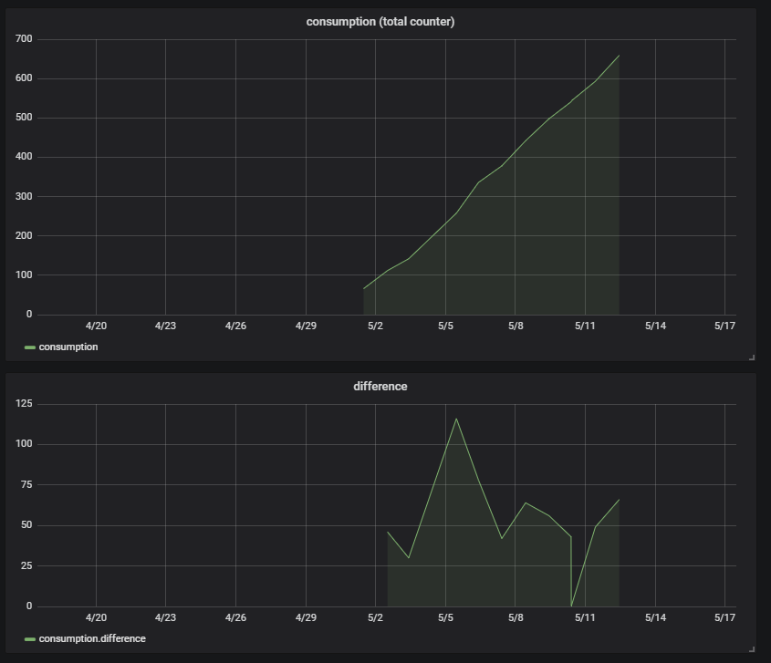

I have to do the opposite. I have a counter that represents the total consumption therefore always counts up. I want to get the consumption by time period.
When the time interval of the data is constant and there is no missing data then it’s simple with the difference() function.
unfortunately that’s not the case.
I set-up a demo on my home server with the problem.
http://81.83.6.53:3000
Problem discription as follow:
interval of logging total consumption counter is not fixed! Demo data is once a day in the morning, with 2 ‘error’. Missing data on 2018-05-04 Multiple data on 2018-05-10, even once with same consumption counter (no consumption)
with difference() function you see the spike at 2018-05-05 (which is consumption from 2 days, because of the missing data on 2018-05-04) and you see a very low (and even zero) consumption on 2018-05-10 because of the multiple data on that day.
I already tried different plugins like histogram, different functions like difference() and integral(). None with the desired result, consumption by time period.
Time period must be flexible. Here the data is daily, but it can also come in every 15 min.
To view daily from the 15 min data, I can use sum() To view on 15min base, from daily data, I want 96 times the same consumption (spreaded out). To view the demo data (daily) on 15min base, I want for every day around 96 values who are the same. except for 2018-05-10, because there the interval of data is more frequent. The term I found latest was BUCKETIZING or PRE-BUCKETED DATA
