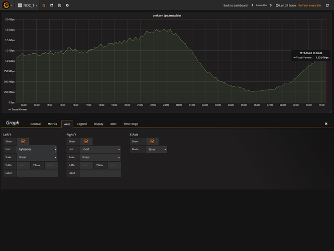

My input is bytes/sec, but the graph doesn’t show the right value:
But when I select bytes/sec it shows it it bits/sec:
Can someone help me out?
Looks like I’m an idiot, it’s showing the correct data, but is there any way to display the graph in Gbit/sec instead of GByte/sec?

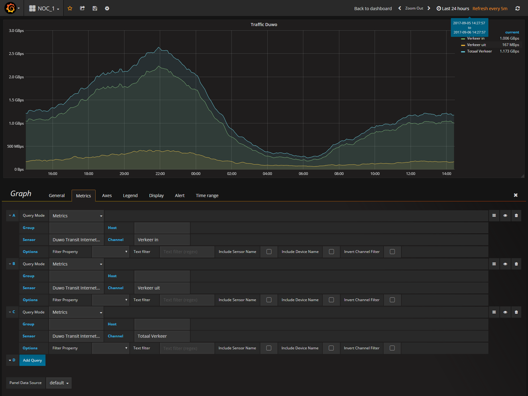

Yes, here I’ve got a screenshot of PRTG and a screenshot of Grafana:
i need try replicate your configuration here, but need exactly how to get the info from sensor to see where is the problem (template/variables)
