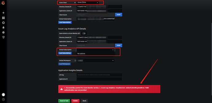

Hello,
I use the free version of grafana-6.7.1.
Select azure China Cloud in datasource, configure azure log analytics API details column in azuremonitor to fail to automatically list “default subscription” options, do you have anyone who has the same problem? Can you help me solve this problem? Is there a problem with the grafana API interface?
Thank you to everyone for watching and replying.
Exactly the same problem, not solved yet
I’m using grafana now_ In v7.5.3, this problem has been solved successfully.
