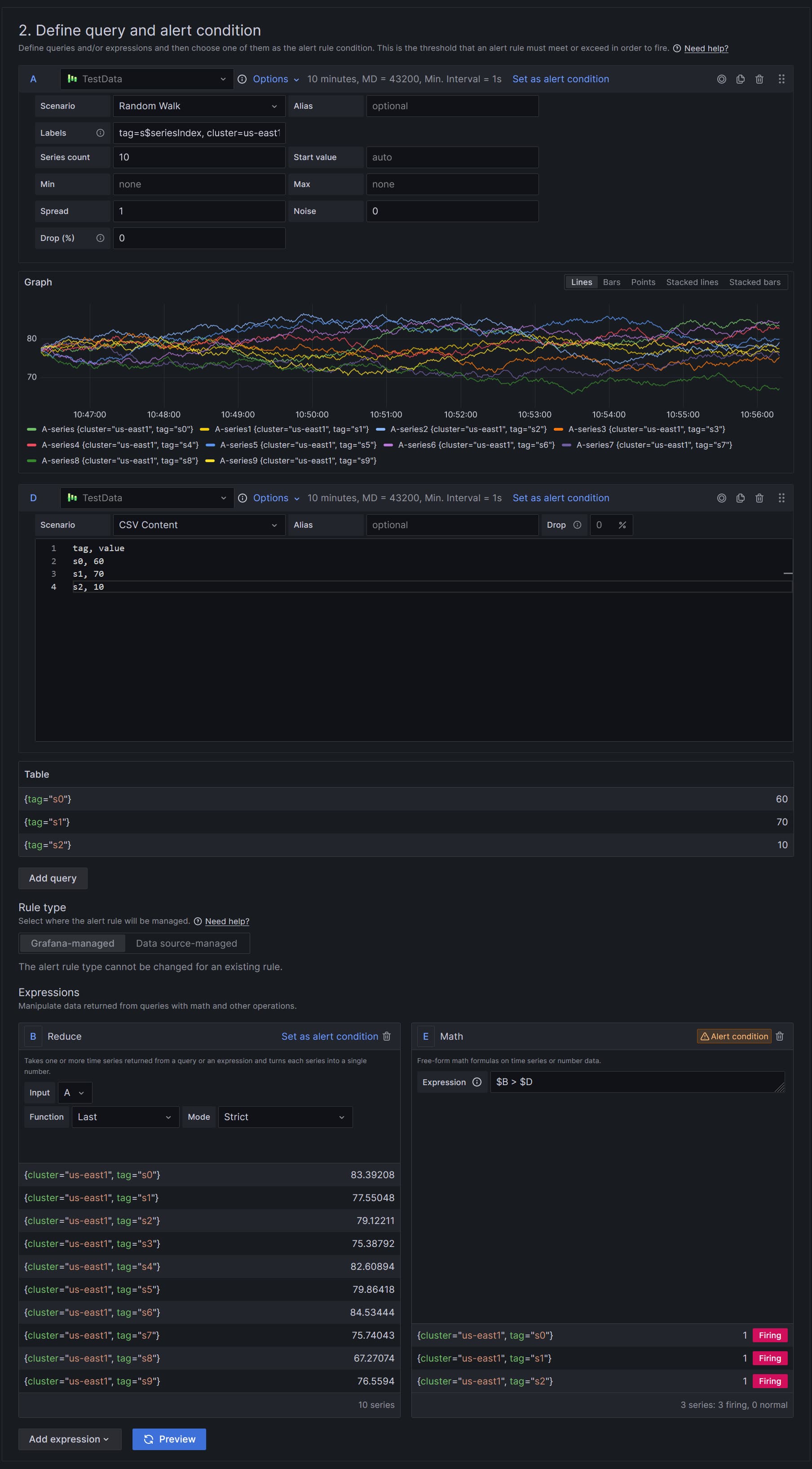

It is possible using two data sources and Math expression! One data source that provides free disk space and another that provides thresholds. The only requirement - both data sources should provide exact the same set of labels!
Here is an example based on two Test data sources.
The most crucial part is that $D should have subset of labels of a dimension. Math expression merges $B and $D by traversing every metric in $B and looking for a matching set (or subset) of labels in metrics from $D. In this example, threshold 60 is applied to all metrics from $B (or $A) because they all have label cluster=us-east1.
IMPORTANT: If match does not exist the metric will not go to the result and you will not get alert for it
The rule in the following screenshot is updated to match by labels that are unique metrics in $B but $D does not mention all metrics in $A and therefore they get dropped
Unfortunately, I can’t think of a way to have a way to express a fallback that would match all unmatched metrics from $A.
So, if you opt in to this workflow you must deal with possibilities of dropped metrics.
