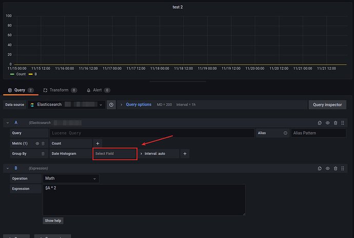

Good news: I have figured out, why didn’t Expressions work for me.
Simple query [with timestamp field not explicitly set] - OK:
Simple query [with timestamp field not explicitly set] and math expression - not OK:
Simple query [with timestamp field explicitly set] and math expression - OK:
Bad news for me: I can’t use Expression in my alert, because I use Legacy alerting :expressionless: And I’m not really going to switch to Unified alerting in the nearest future.
